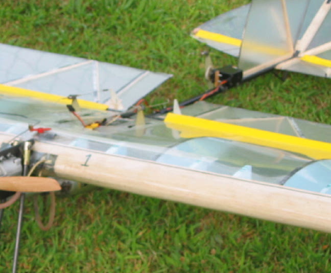

I was just looking through my photos from this summer at the NCFFA nationals and looking at one photo reminded me of something I though I should share with the guys in here.
I know for my self when I need the extra travel on an control surface I look to for the Dubro long servo arms in my servo-arm box. between that and the computer radios usually I can get the travel I'm looking for.
this summer I had a chance to look at some other builders and see different tricks. one guy had and interesting idea. he was making his own servo arms out of light ply. he would mount it to a round servo arm with two screws and presto you know have a servo arm as long as you want. Take a look at the attached photo to see what I'm talking about. look closely at the elevator servo on the boom.
this is as clear as I can get the photo

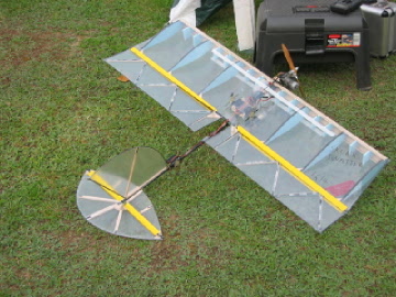

Default better photo
found a better photo. it looks like this guy actually used plastic.
different guys were using diffent methods.
Old 02-05-2003 | 01:34 PM
Posts: 1,509
From: Easley, SC
Default I appreciate that
I have taken two DuBro giant scale servo arms in the past, cut the ears off of one and fasten them onto the other arm in order to extend them. This has worked for me. I like this idea, if I can find the material.
Thanks!
Kevin
Old 02-05-2003 | 02:52 PM
My Feedback: (12)
Posts: 5,133
From: Pampa, TX
Default Looks like..
I bet it's G10...circuit board material. Tough stuff.
Old 02-05-2003 | 03:14 PM
Posts: 568
From: brooklyn, NY
Default plane
here is a photo of the whole plane.
someone must recognise the plane. maybe we can get the owner in here for some input.
on the wing it says Skunk Swatter.. has to ring a bell with someone
