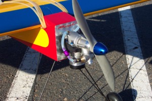

Hey Thanks alot Airworthy! That helps alot. I have gone through 2 pairs of landing gear for the magic(and I don't land hard,honest) so I you sure are right when you say the magic landing gear breaks! yes I have flown many other planes there are some guys out at my field that own 40% and they are kind enough to let me fly them a good bit. And a also have or had a Morrison knife but my engine cut while I was hovering about 6-8 ft. off the ground so you can figure the rest out on your own lol. I have been messing with the cg a good bit and it has really helped.I would REALLY like some carbon fiber landing gear but the only thing I can make out of CF is a servo tray so do you know were I mite be able to find a set of landing gear or do you know of anyone that has the skill to make a pair? Aslo does anyone make a CF prop in a 11x4? I know thats small but I would love to have one! If you look in the gallery under fun fly(think it's the 3rd page) there is a guy with a magic and he has some kind of cool looking metal or aluminum piece on his fire wall. Does anyone happen to know what that is? Thanks again

Hey can you guys figure out what he has on his firewall.(the thing he has his engine mounted on) It looks kind of like alumunum but It mite just be a sticker . Thanks for your help! LATER DAYs

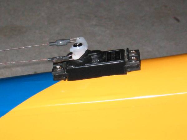

This is a great way to move your CG aft without adding any weight or cutting a large hole to put your Rx batt.

Hey would somebody PLEASE tell me what this silver thing on the fire wall is! What it does and and also where I can get one. Thanks alot!!

Oh by the way its on the prev. page
