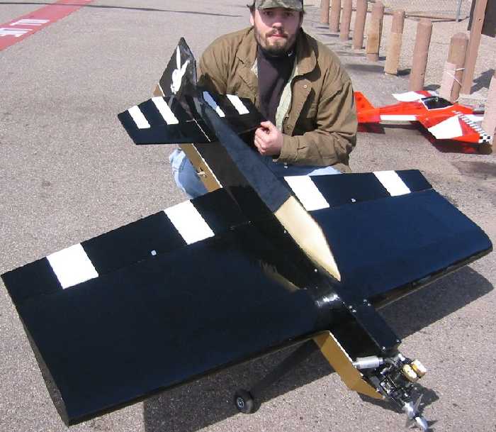

Here's a picture of my Ecstasy. I'm not done with the graphics yet, but I like to fly them a few times before I get too crazy
That's my Pizazz in the backround (been through hell and back)

Where's the babes? - Hugh, I mean Heff, I mean Kevin
Looks radically different with the engine rotated up and missing that top nose pc. You're right, it needs some more graphics. I am so glad that you're enjoying its flight characteristics. It is a pretty awesome bird, but it means allot more coming from a customer over the designer <LOL>.
