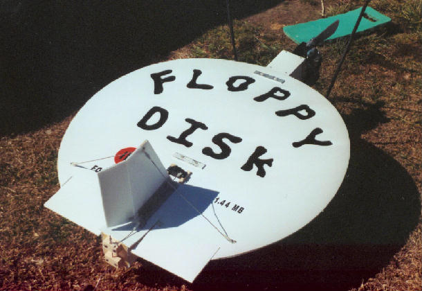

A couple weeks back I was checking out the hangar hangout section and came across a listing for weird planes. In it I saw a disk plane build by (basmntdweller) and what really caught my attention was the statement he made about the plane. He said he could hover this plane for as long as he wanted to hover it, for a full tank of fuel if he wanted. I love to hover so this really got me going. I e-mailed basmntdweller and he sent me three pictures and a brief write up to describe the disk plane. It is an all SPAD plane (Simple Plastic Airplane Design), and it can be built in as little as two days or less if you hurry. I built mine in about that amount of time and this was the first SPAD I have built. It is so simple to build I think everybody would like one because the investment is almost nothing, and cheap is good in this case.
The disk plane uses rudder and elevons for control. I used an os 46 fx that I had in storage and it is plenty of power for this plane that weighs in at 5 lbs 2 oz. It could have a smaller fuselage and glue on wings and it would probably weigh around 4 lbs 3 oz. The wing is only 4 mm thick and it is amazing to me how well it does fly, even inverted. This makes me wonder about all the airfoils I have built in the past. It will hover right down to a landing and flies well in high wind. I plan on building many of these planes so I will always have one at the field. I think most guys build it with the wing glued to the fuse. I built mine with removable wings and it is really easy to transport and store a round wing. I have been flying for many years and have owned many different planes, but this one takes the cake. I am glad I came across basmntdweller.

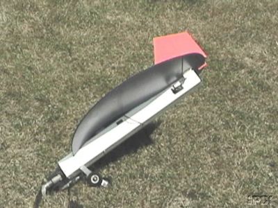

Here are the specs I received from Matt in order to build the disk plane:
Specs,,,,
32" dia with elevons 19" wide across the back. The elevons are hinged 5" forward of TE and are setup with about 3" travel each way. Os 32 heli engine is best choice. I use OS 32 airplane but it gets hot. A friend has the heli on his disk and runs much cooler. APC 10-3 or 10-4 prop. I prefer the 10-3. The fuse is a formed channel of coroplast with cradle made of 3/32 ply. The cradle holds the fuel tank rx battery and throttle servo. There are three coro formers aft of the cradle. Everything is glued together with thick CA. It balances 8" back from the LE. The wing has an airfoil to it created by the top of the fuse. From the side view, at the LE the wing is 2 3/4" from the bottom of the fuse. back at the CG it is 3 3/4" high. Back about 8' forward of the TE it comes back to 2 3/4" high and from there it has a curve back to about 3 1/2 high at the TE. At neutral, the elevons are level with the bottom of
the fuse. From the pics you can get an idea of the fin size. I think
it's way too big but haven't cut it down yet. Anytime you screw through the coro you need to have something to keep it from crushing. I ripped up some pine strips that fit in the coreholes of the coro and ca them in place. That is how my servos and the handle and fin wires are held on. I have my elevon sevos about 5" forward of the hingline and the rudder servo just forward of the fin. Fuse is 36" long and is flush with the elevons at the TE. I'll follow this e-mail with some more pics.
Later,,, Matt

If you decide to build one of these disk planes I would recommend that you use a bolt on wing and add a steerable tail wheel. Simply mount a tail wheel to the rear of the fuse and connect it to the rudder horn, a real simple hookup. The plane will steer without a moveable tail wheel, but the plane has to be moving pretty fast for the rudder to turn it. If you want a tight turn use the steerable tail wheel. James Goss

I am using an 8–ounce tank. The fuselage is 3-inches wide so there is plenty of room for your tank and controls. To balance mine I had to place the battery at the rear of the fuse. With the receiver midway it will reach both the battery and servos in the rear and also the throttle in the front. The rudder is effective and I plan to leave mine the same size as my first plane when I build more of them.
Since I placed the disk plane on RC Universe I have had several more flights with it and have learn something about it each time I fly. Here is the latest; it will do a perfect flat spin. When I say flat I mean flat as a pancake, not with its nose up, and at times it will hold its altitude without descending. It also has a move of its own that we call it a pirouette. It is a spin with its nose up high but not vertical, and of course with its nose high attitude it will maintain its altitude or ascend with more throttle. It is easy to get it to descend while doing this pirouette, and it is like a giant tail slide all the way down to the ground if you like. I have done several descending landings from about 50 feet high with engine still running. I haven’t tried the disk with a steerable tail wheel yet, but I know it will perform better being able to turn tight on the ground. It may even do a doughnut takeoff. I have had some planes that would almost leave the ground in a doughnut spin, but not quite. This could be the first. James Goss

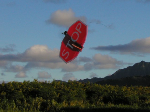

The greatest thing about the Floppy Disc project (besides the incredible flight characteristics) is the modifications possible. Here's my Stop Syn version of the disc. Let your imagination loose. Enjoy. WH.

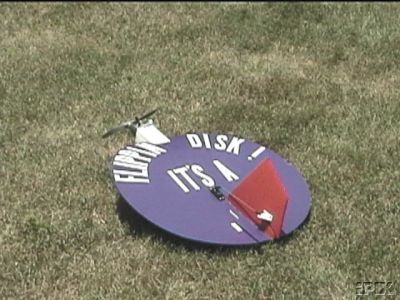

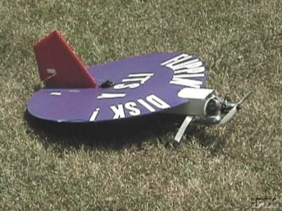

Posts: 575
From: KS
I started making kits for my version of the Floppy Disk a few months back, I call it the Flippin Disk. These are a 24" disk and use .25 -32 size pro engines or 30-40 size bushing. They are alot of fun , I always have one at the field.
