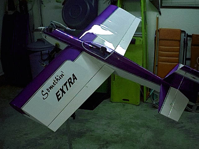

Default Lighter is better
I used a Webra Speed 50 on mine. Lots of power and light. Small as the engine compartment is, I think the larger engine would be a pain. To each is own.
JIM

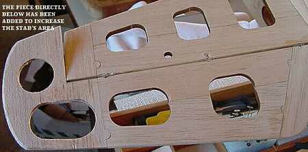

I have built and flown several SE's since they first came out.
My current SE is powered by an OS .61 SF with a tuned pipe running 25% nitro Omega fuel.
This is the 9th engine I have used on the SE and it is my favorite by far.
I can still do all the usual 3D stuff like torque rolls and hovering but it also has REALLY EXCELLENT VERTICAL PERFORMANCE.
The engine is now partially enclosed and uses a 2 3/4 inch spinner.
I moved both the elevator and rudder servos back to just in front of the stab.
The rudder is 3/4 inch longer - The elevator is also 3/4 inch longer with counter-balances added (see attached picture) NOW it REALLY does 3D and knife edge!!
I opened up the bulkhead behind the stock tank location so I could install a 14 ounce tank.
The landing gear is taller and is off a Great Planes Extra 300-40 which gave me the clearance to run the 12X7 APC prop.
After over 200 flights the wing tube began to loosen and make a horrible noise vibrating and was allowing the wings to move about so I bolted the wings to the fuselage sides.
BTW: DO NOT leave off the tail wires. If you start to really wring the SE out the tail feathers will fail with out the wires.
