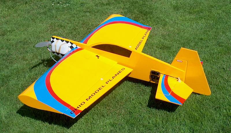

[sm=thumbup.gif] You're going to LOVE your Mojo!!! I bought this one from Snap It last fall and finally flew it last weekend. Power is a Webra 50 with APC 12X4, 821 Digitals on all flying surfaces. Vertical performance is ballistic, yet in can slow down to a crawl in harrier - looks like it should fall out of the sky, but it doesn't because it is so light. The lightness is the reason for all the hype about profiles like the Mojo... Mine came out at 4 lbs 2 oz, and I didn't even try hard. I have a 1200 6V Nimh batt, standard RX and a HS85 on throttle. If I had used lighter servo's, RX, and battery, I could have easily been under 4 lbs., but I am very happy with it the way it is. The performance is amazing.
