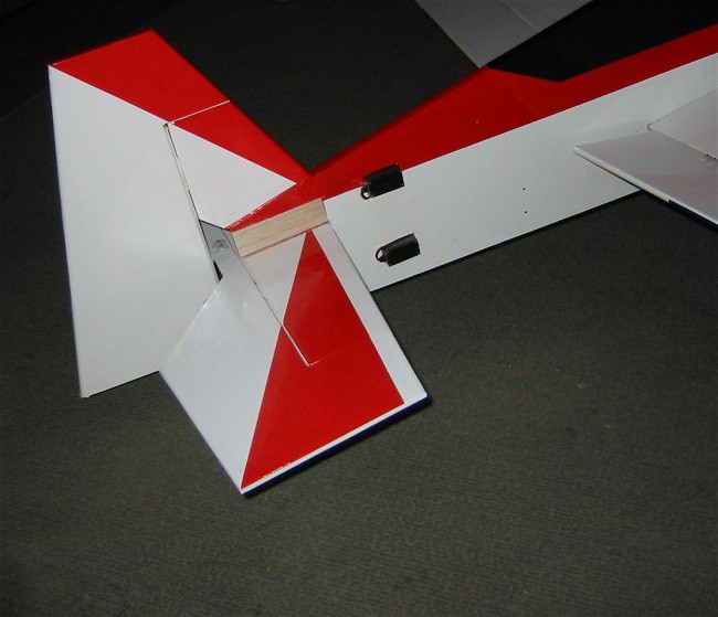

Well, i took the plunge, and chopped up my new toy.
After several minutes of scratching my head, just decided to try moving the stab down an inch.
Started by carving out the area below the stab with an exacto. A little sloppy, but it works. Fortunatly by the time i was ready to seperate the stab from the top i found a better way. I just took a hacksaw blade and carefully sawed from the back of the stab to the front. Pretty easy so far.

Old 05-14-2003 | 03:24 AM
Posts: 1,652
From: Tucson, AZ,
Default Extreem 330 rudder coupling?
Glued in some balsa to form a new shelf to glue to on the bottom, made a block to fill the gap on top. The control horn will have to be switched around to the top of the elevator. Looking forward to trying it out on Saturday.

Old 05-17-2003 | 05:17 PM
Posts: 1,652
From: Tucson, AZ,
Finnally got to test the stab modification today. Still pitches to the belly a littel, but a lot less than it did last week. Tempted to move it down some more. There is a large hole between the vertical and rudder. If i fill it it will probably help keep the pressure above the stab a littel higher and reduce the pitching a little more?
Old 05-18-2003 | 09:15 PM
Posts: 458
From: Pensacola, FL
Default CG..........
I've noticed on mine that when I got the CG correct it no longer wanted to tuck to the belly. I took all the mixing out and it is pretty neutral. Just wants to barely climb when inverted (have to give it just a little back pressure on elevator to get it to go straight and level). It will knife edge loop with only small corrections. I also dialed in more right thrust. Engine is Saito 56 with APC 12x6, JR DS811 servos on flight surfaces with HS225 on throttle. When the tank is almost empty it is a pain to land if windy (this is the only negative).

Old 05-18-2003 | 10:02 PM
Posts: 1,652
From: Tucson, AZ,
Thanks Jon,
I'll add a little weight to the tail and try again. Do you know how far back your CG is?
Old 05-19-2003 | 01:40 AM
Posts: 458
From: Pensacola, FL
5 3/8" from the LE (measured where the fuse meets the wing LE), or about 1 1/4" behind the spar. You can tell it's tail heavy when it is going slow, but I"m satisfied with it there.
