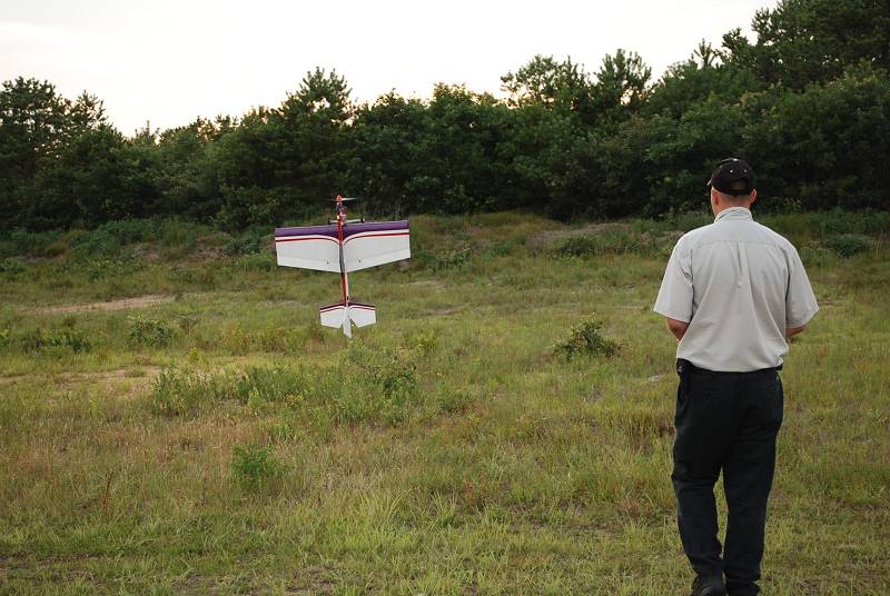

I have been flying mine for almost a year!
Great profile to convert to electric.

Hi RickC2009,
Can you give any details on your electric conversion?
thanks,

eflite power 32 out runner
13x6.5 apc E prop
eflite 60 speed controller with switching bec
Flightpower evo 20 4s 3300 battery
Hitec hs 225 servos, spektrum dx6i and 6100
800 watts of static power!
flys great!

Hi Rickc
Thanks for the electric conversion details.
Can I be a pain and ask a few more questions.....what is AUW read to fly, what typical flight times do you get out of the 3300's & how well does it pull out from hover?

no pain at all, ask as many questions as you like!!
auw is 4 pounds
flight timer is set to 6 minutes
hovers at 1/2 throttle and punch out from hover is great!
