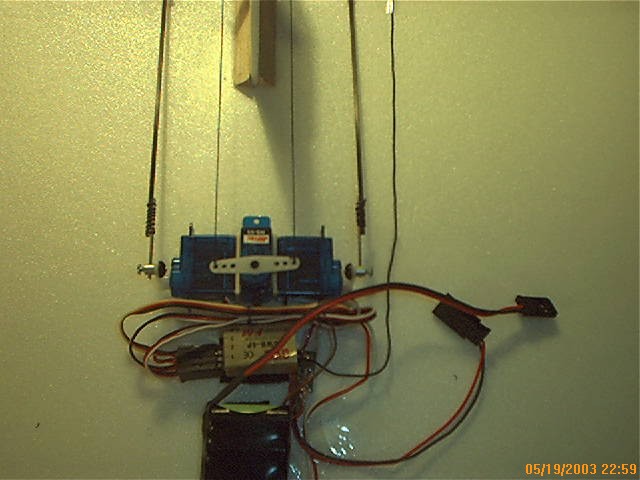

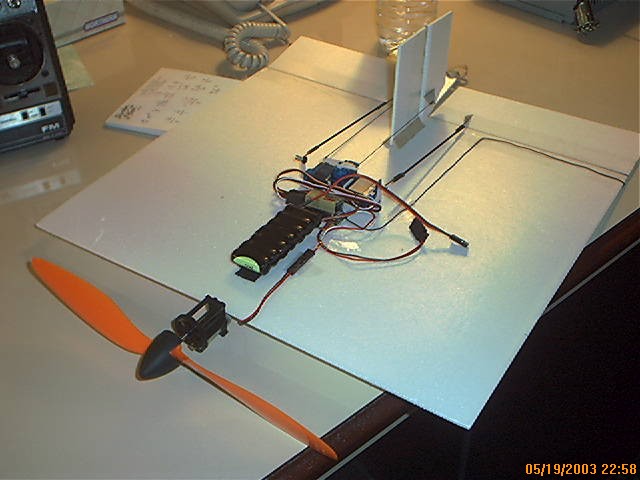

Default Micro PBF
Here's the little micro PBF I built when I was up in Buffalo... Did touch and goes on the hotel room bed... LOL!!

Default Micro PBF
I used a GWS IPS A motor with a 10 x 4.7 prop. HS - 55 servos, GWS pico RX, Castle creations 7 amp ESC, 8 cell 300 mAh NiMh packs. Zepron 3 mm foam for everything else... Hinged it with packing tape.
Had a lot of fun with it in Buffalo.... was out flinging it kinda late when it was almost dark... I was banking around a turn and got it skewered by a tree.... It was flying along then all of a suden... it just stopped mid air.... I couldn't stop laughing....
Over all it flew pretty good.... Had a hard time doing loops... and when I rolled it, it would stop when it got inverted.... I think it needs more power....

Kevin - I bought one before I built the Micro PBF... I didn't have time to build it and I didn't want to ruin it on the trip to Buffalo.... So it sits in my Garage awaiting some time.... I thought the same thing about the rudder... What motor, battery, servo's did you use? Can you post a pic of your rudder mod?

Paul - I went with AV8's option #2 set-up for my mini Gee Bee with an extra servo of course. Option #2 has the Li-On 560 mA, 3 cell pack, GWS PICO Std servos, ESC, GWS A motor, & GWS 10x4.7 elec. prop. Works great! I incorporated the rudder after trying to get the curvature out of the tail of my fuse. I tried to get it out during assy. without any luck. I test flew it with only 2 servos, and didn't like it. I then cut the rudder and rigged it out. It was great after that. I'll post a pic later, though it is ulgy since I cut my rudder after assy.
