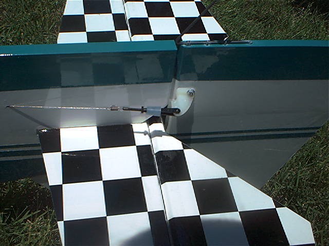

Can any one post pics of their pushrod/pull pull set ups? Need some close up visual aids.
Old 06-10-2003 | 02:59 PM
PaulSwany's Avatar
My Feedback: (45)
Posts: 4,811
From: Bartlett, TN
Default Pull-Pull
Here's how I did it on my first Taco:

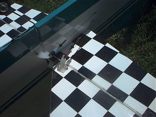

Default Tail
The tail setup:

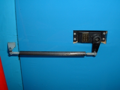

Default Other side
Here the other side of the tail

okay so what do the pull pull do inside the fuse? If I would have thought about it before covering I would have put inside also.
Do you have a small rod or something that they run through inside fuse or a metal round eye or something to keep wires close together? I am trying to figure a way to make mine work out outside of fuse.

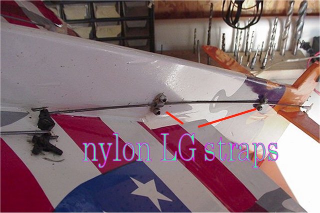

heres how you can do it with 30"rods, I use nylon LG straps to hold them onto the fuse, 2 per side, I also try to line them up so they are directly across from each other on opposite sides of the fuse

I use the push rods and LG straps now too... But if you wanna do pull-pull outside the fuse.. You can use the LG straps and short pieces of antena tubing or inner nyrod to act as guides for the pull pull cables. You'll have to cross drill the fuse for the rudder and insert a tube into the hole..

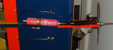

Bought a digital camera yesterday. This is a good excuse to post some pix... CF pushrods on my new profile fuselage Something Extra:

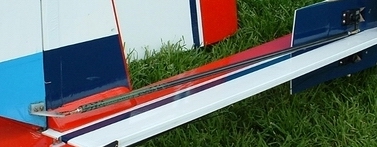

Default You can use 'em for aileron too
On the bottom of my Wasp
