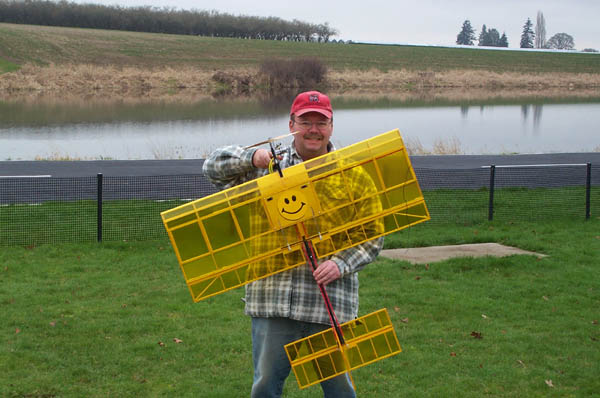

I'm in Oregon too, about an hour from you up near Banks. Here is a pic of one of my planes. I call it Super Happy Fun Plane.
It weighs a smidge of 2 lbs... always less than 2.25 anyway... and although it has a diesel on it in the pic, I now fly it with an FP .25. Very nicely powered.
I am working on plans/pics/article for a model magazine now. If your interested, let me know, could probably send you some drawings shortly.
