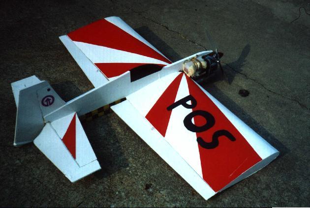

This was the last shot I got of mine after a year or so of flying and at least 400 flights...Flew it at least once a week, sometimes 4 times a week for the whole year. What a fun plane!
I still have my Extra Special 40 which is almost identical to the Fun 51 with the exception of the shape of the profile. I am in the process of enlarging the elevator and rudder. The easiest way to add the extra length is to take a 1/2 wide balsa stick and just lay it inline with the trailing edge of the rudder and elevator and draw your new trailing edge. Doesn't get much simpler than that. I powered mine with a .46FX and the vertical was unlimited but pull was slow out of a torque roll. I have since found that the BB .46 engines like the APC 12x4 prop better than the 12.25x3.75 apc prop for hovering and throttle response. The narrower blade gives the engine much better throttle response. Also, I know the tower muffler is cheap at $12 but pales in comparsion to the rossi mini tuned pipe conversion for the .46FX sold by Morris Hobbies. You can find them online. The rossi pipe cost more but the performace difference is large. Better torque, smooth as silk midrange, and lightening like throttle response. It produces at 1500+ rpm gain using a 12x4 APC. This is like putting a afterburner on. It also fits the plane better than the tower muffler too. It does cost around $54.00 but is worth it completely.

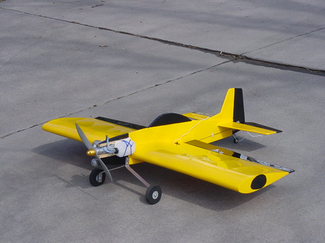

Here's mine.
It was my first kit build and I learned alot from it.
I've actually had the gear break the wood away from the fuselage 3 times. It's a real pain to fix to so make sure you strengthen it somehow in the beginning.

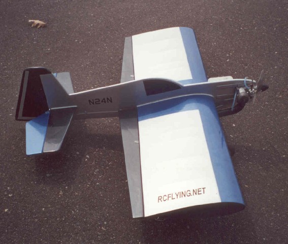

Nice plane Kris3D...
