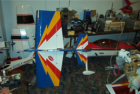

After watching me fly my OMP 65" Yaks and letting quite a few guys fly them using my two JR 10 X's set up in the pilot link mode. Two of my buddy's just ordered two of the 47" V3 Pro Yak Arf's with the OS AX 55 combo. I guess I'll just keep flying my 47" Omp V1 Pro Yak Arf. One of them is going to have me build his for him, so I'll get to try the new one soon. LOL!!! I enjoy being the Chief test pilot at our club.
