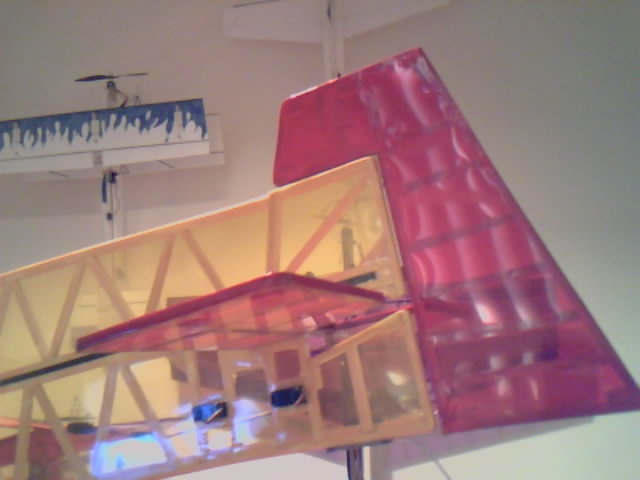

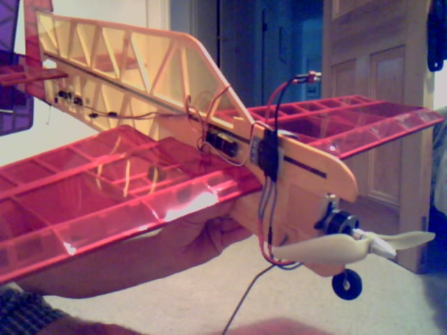

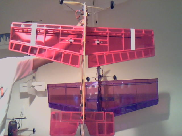

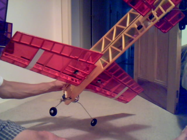

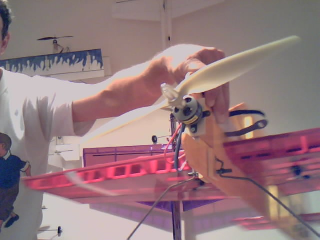

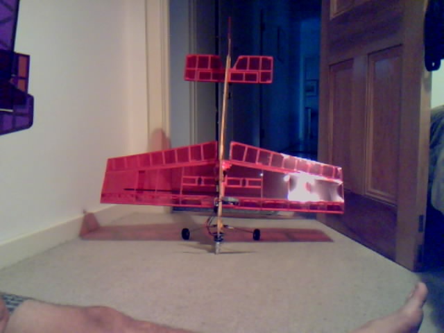

Hi this is my no plans scratch built profile,it took a couple of days to build and cover its a simple and quick build,and is very strong and can handle a fair bit of wind,the wing span is 37.6 inches and the weight without lipo is 500grams,Ive got an eflite 480 1020 kv outrunner on it ,with an 12x6 prop and the power to weight ratio is pretty sick ,the servos im using are hitec hs 65s and the esc is turnigy k force 40 amp ,with a spektrum 6110 e reciever ,the landing gear is eflite apprentice,with carbon and cotton with some ca holding it in place,This is about my 16th or 17th scratch built profile they all take roughly the same time to build and as i said are really strong and can take a few knocks to the ground,so there good for learning different tricks,any way i dont have any video footage ,but its really stable for harriers upright and inverted and is all so an easy plane to hover and cause of the tall fuse is extremely easy for knife edge it goes so slow and low,and it does cool looking tumbles and other flip tricks,and knife edge spins. heres some pics.
