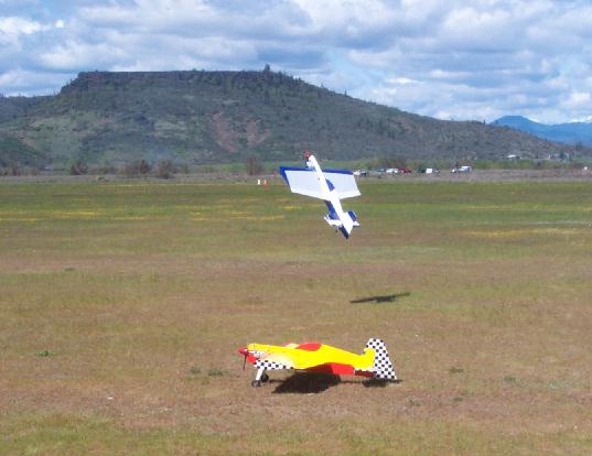

Today, we tryed something different. My son Brad used his plane as a trainer plane, and hovered it in front of my plane to train it how to hover. After doing this I hope that mine will be alot easier to hover.
