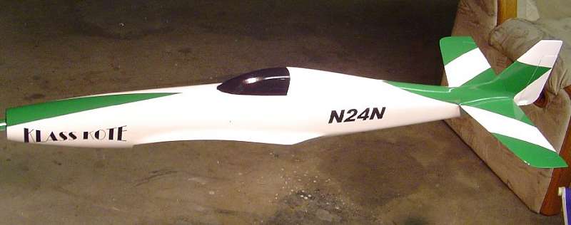

I got the last coat of color down tonight. Turned out pretty good (for how I paint), just gotta get the clear down tommorrow, and hopefully I'll have time to get the radio in so I can test on Saturday.
The Klass Kote works great, but the humidity we've had lately has slowed down the drying process.
The wing still needs to be stripped down and painted, but that can wait for now.
