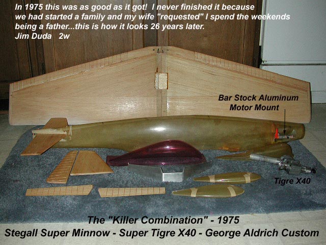

Jim Duda's Avatar
Joined: Apr 2006
Posts: 330
From: Austin, TX
Default RE: wood props
Stegall Super Minnow - Aldrich custom X40...Rev-Up WOOD PROPS (wink)
Old 03-12-2007 | 11:18 PM
  #50
BUDMAN27's Avatar
Joined: Mar 2006
Posts: 1,591
From: Galveston, TX
Its never to late Jim I say put that babby together and let her rip tater chip.
