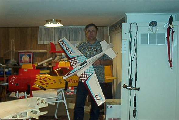

Hi pwood. You have to remember most sport planes only fly at an average air speed of 80 MPH the Q40 you are getting ready will do an easy 180 mph. if it is the same competition style we fly in the states. Full control service travel in say elev is less than 1/8" up and 1/8"down. Know put in fast servo's and you are going to have one fun time trying to control that Baby. I guess you can do what you want.Have Fun!!! Here is a Pic of my practice Plane the eng I fly it with is a Nelson Q40 This Plane will do an easy 180 mph, with the futaba servo's all day long. I listed the servo# earlier
