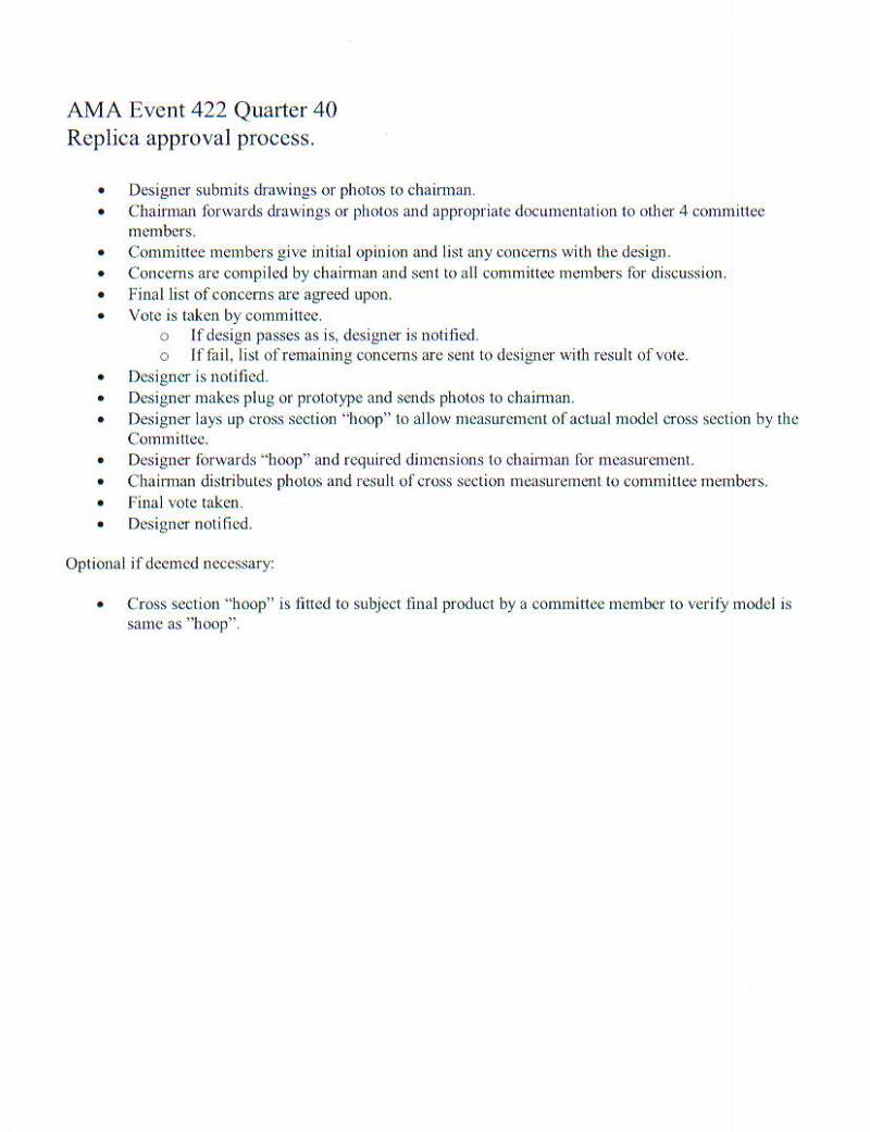

Lee,
You need to send 5 sets of drawings. The drawings include three views of the full size plane as well as the model. One of the most important things is to include a cross section showning the shape and the 12.5 square inches of area. I don't know if Jim is still heading up the committee but if you send him a note I am sure he will steer you in the correct direction. The drawings do not need to be full scale, but if there are any areas that you feel are questionable, you should point them out with detail.
Looks good, when are you going to do it? You better get started.
DK

Replica approval process and Replica rule comparison gudelines.
ID:	870624   Click image for larger version
