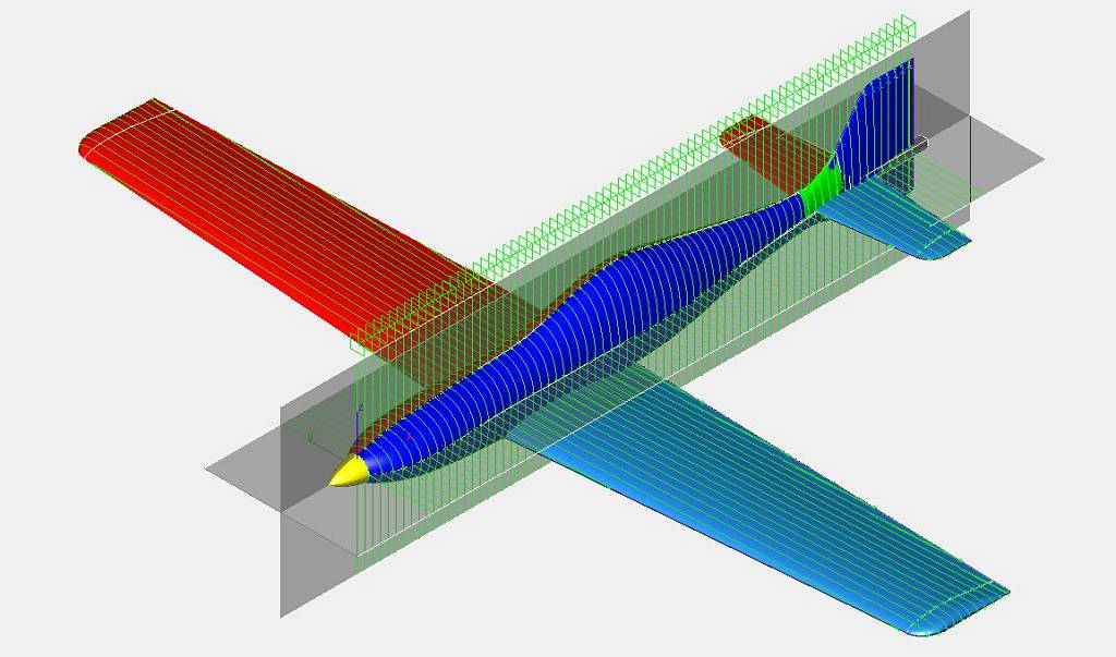

After much waffling I've finally got an approved Q40 design based on Mike Arnolds AR-6 Endeavor..
To start with, the plug will be made with formers and foam.. Assuming everything goes well I'll look at an aluminum mold at a later date.. I'm doing a couple different wings to try before moving forward with a wing mold..
I sent the DXF file out to the laser cutter last night so hopefully next week I'll have some pics of the build..
A special thanks to Gary CAD work, it turned out way better than I could have hoped..

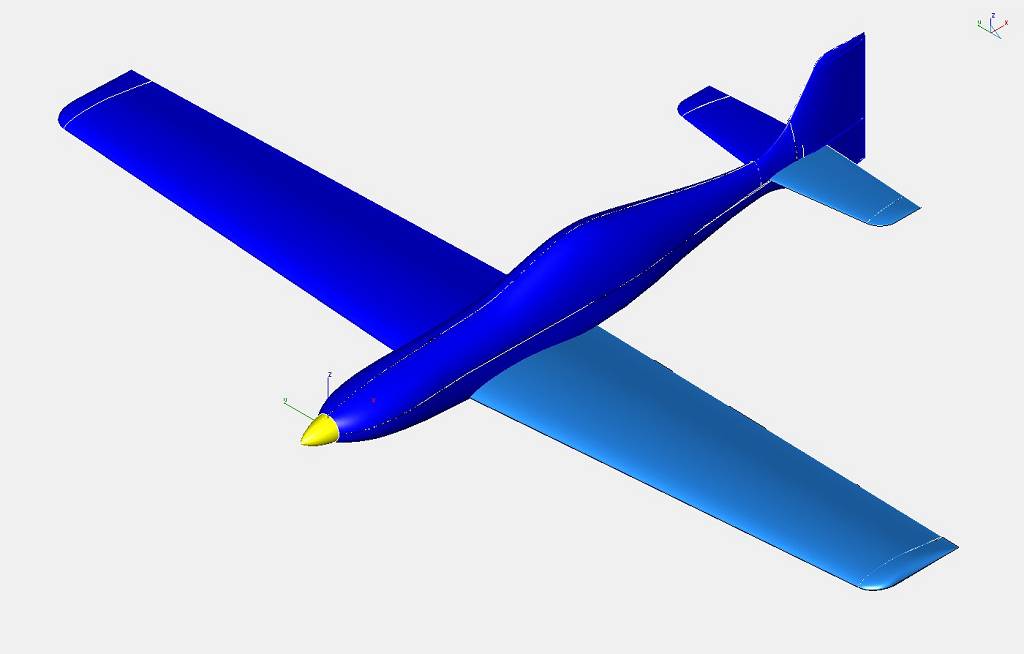

Here is an image without all of the additional artifacts.

Thanks Gary, I didn't have that one with me..
I plan on showing my progress with the plug and mold.. Like I said, I should be starting on the fuse plug next week sometime..

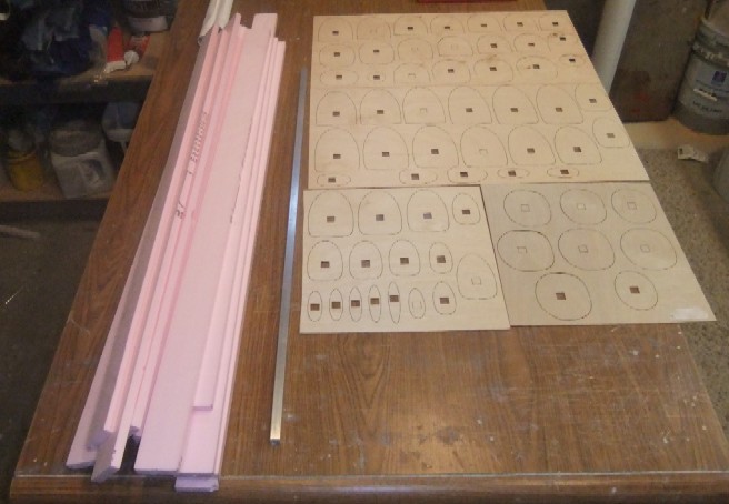

I got all my foam pre-cut into strips.. If you notice in the first post, the fuse is disected every half inch.. I cut some Dow foam into 2" x .5" strips so I can just trim them to shape as I go.. Hopefully there will be all sorts of foam dust in the workshop this weekend with pics to come..

After much screwing around I'm finally ready to start.. In the pic you can see the laser cut formers, the square shaft and the foam.. I don't think I have 5min enough epoxy, might have to make a run to the hardware store before it's all done..

Hey Lee:
Keep an eye on that spacing, like we talked about. The templates were made for 0.5000 spacing and if the foam PLUS the template material PLUS the glue is thicker or thinner than that, the tolerances are going to add up. Put marks on the tube to insure that you are staying lined up, otherwise the plug won't come out the correct length.
