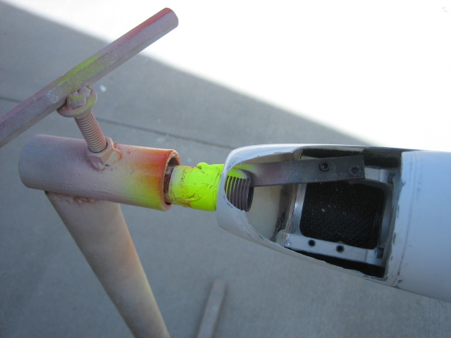

If you are going to paint airplanes make yourself a stand it saves alot of hassel for the few minutes it takes to make. I have seen them from wood to steel, here is mine .
The fuselage mounts with the motor mount and the wing uses the wing bolt holes.

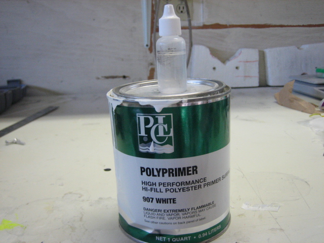

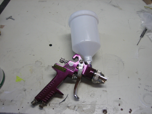

The first picture is of the primer that I use. It is PCL poly prime it is fairly inexpensive and works great. I mix it as directed and then add about 5 to 10% of lacquer thinner to thin it a bit.
The second picture is of the gun I will use on this project it is from Harbor Freight and only cost 17 dollars this morning. I have recommended these for years and they work great. Yes I used to paint cars and street rods and I have all of the 500 to 600 dollar paint guns but these things do a great job for what we do with them.
The third picture is of what they call a watter ball. It traps all of the moisture from the compressors that we in our garages. You can get them at the auto paint store.
The last picture shows about how much primer I mix for a racer it is about 4 oz.
D.E.

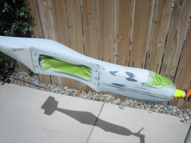

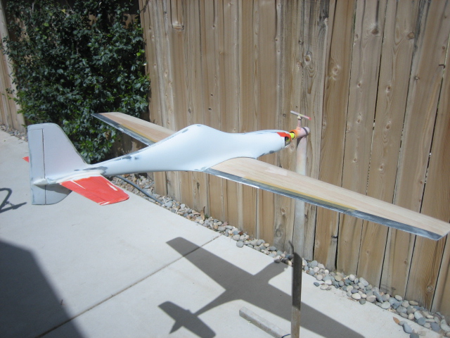

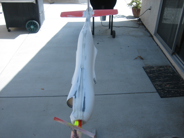

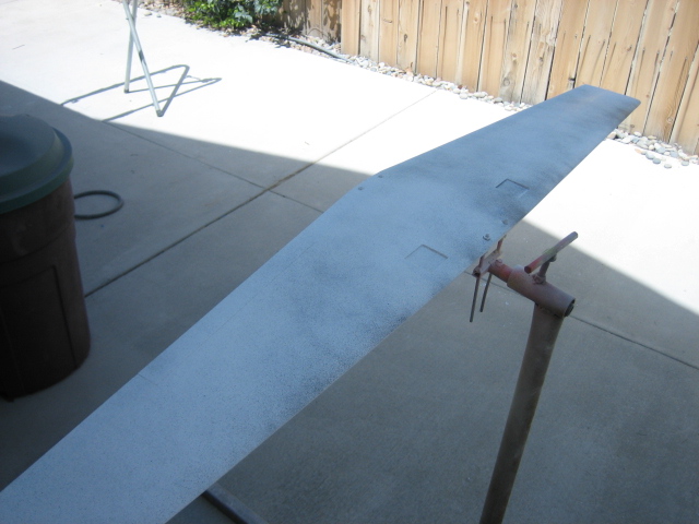

Here the first picture is of the fuse taped off as I dont like getting paint or primer inside the airplane or engine area.
second picture is of the repaired tail ready to prime.
The third picture is of the wing after prime and guide coat. Guide coat is flat black spray paint lightly misted over the fresh primer. It helps you to see defects while sanding.
The last two pictures are of the airplane hanging in the sun drying next to what I should be working on, My wifes 69 RS Camaro.
Tomorrow we sand and paint white.

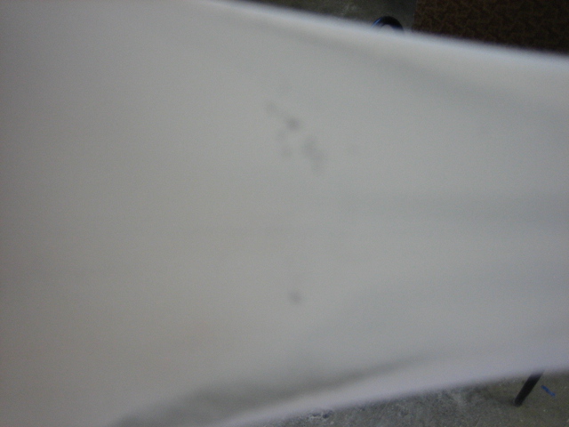

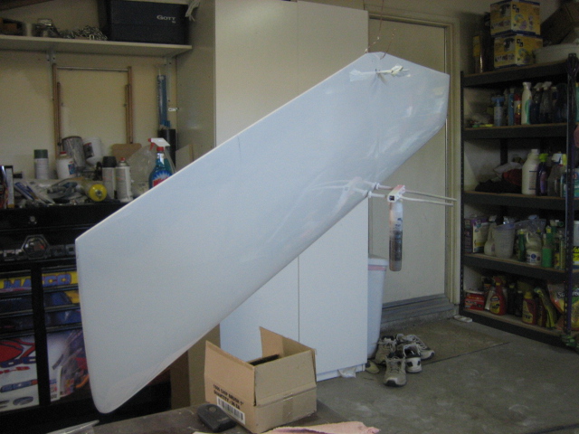

Well this morning I sanded most of the primer off and painted white. Have a look.
First picture shows why to use guide coat. It would be real easy to miss small defects like this. You just sand until all the black is gone.
Second picture is of the wing and how much primer is sanded off. Primer is very heavy and should only be left where needed. I paint the whole airplane with a white single stage urethane ( which is alot lighter than primer. )
Third picture is of the fuse ready to blast.
Dave E.

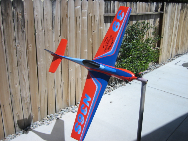

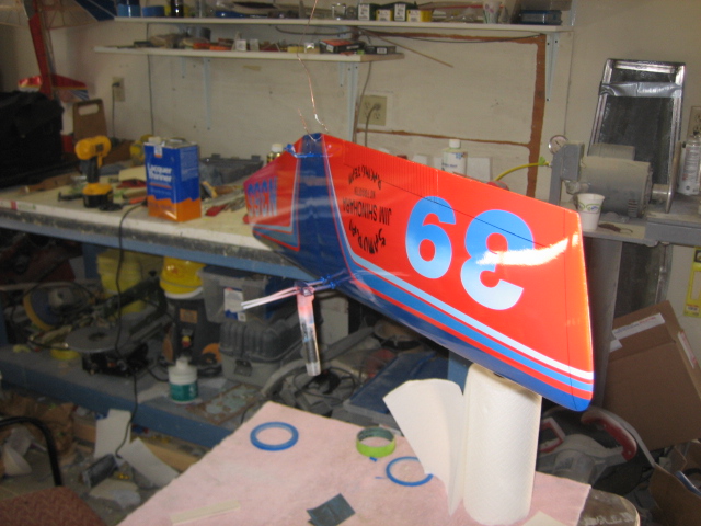

I like to lightly bolt the wing on to lay out stripes it helps to get a good balance of color on fuse and wing.
Here I use the wing fillet to start the angle on the stripeI also paint the fillet the same color as the wing stripe this helps tie the fuse and wing together.
I usually paint the two primary colors first and then lay out my numbers and smaller stripes to proportion all together.

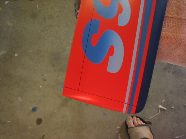

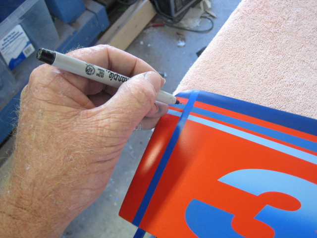

First I went over the stripes with a little 1000 grit to nock down the edges a little. After that I put down a few panel lines, this is really quite easy and in my opinion makes a big difference.
First pic is of the Sharpee extra fine point pen I use you just put a little tape down to follow and go to it.. One of the best I ever saw do this back in the old F1 days was Mike Helsel his airplanes were only two colors red and creme with loads of panel lines they were awesome.
Here I use a stick for a spacer to simulate ribs in the aileron
This whole process for the wing and fuse took about 15 minutes.

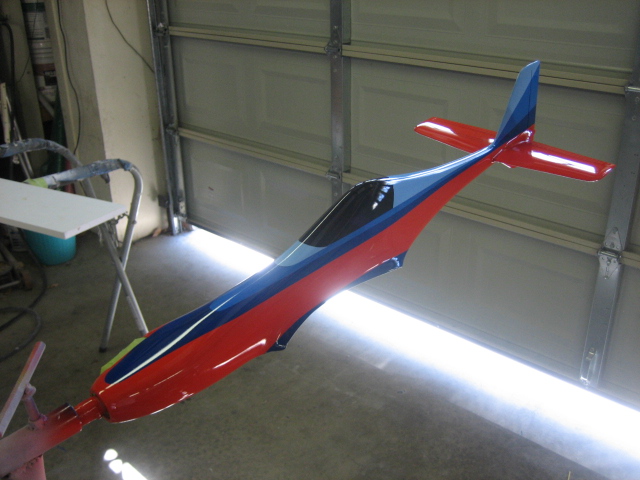

Next was to clear,
First pic is of the clear I use, It is a cheap urethane that is water thin and dries very fast. It is great for models given there life expectancy but I dont think I would use it on a 100 thousand dollar street rod.
Then here it is all cleared, next is to polish it a little and then let Travis crash it at the basin...... Oh well I know the guy with the molds!

Here it is in orange.
I use 3M blue fine line to mask paint edges. It is a little more flexable than the green.
Dave E.
