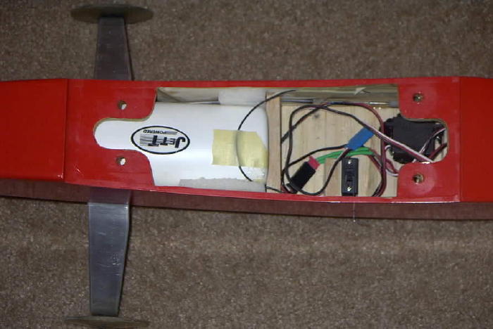

The directions have it in the very front where it barely fits and will be enclosed completely. Is this the best setup? What if I want to change the gas lines or change tanks or change the pickup line in the tank? I'll have to cut through the fuse to get to it (or pry that hatch off). I saw a picture of a predator where the person had it mounted behind that first fuse former that is right at the leading edge of the wing. Is that a better place, and if so, will the stock tank fit there?

Yes Dan that is the preferred place as this will minimize CG change as the fuel is consumed, sometimes referred to as a CG tank. However If I remember correctly the tank that comes with it are just standard tanks and they will not function properly in this reward position and must be forward up front.
The tanks that will operate properly on the CG are either the Jett or Tetra 'Bubbless tanks' that have an internal bladder and the pressure line is introduced between the flexable inner bladder and hard outer shell. These tanks perform very well on the CG. They do require fueling with a syringe in order to vacate the air before pushing the fuel in. Check the Jett website for a tutorial on there use and for tanks as well as syringes (tankers).
If you use the standard tank you will have to grind a hole through the #1 bulkhead for clearance and wrap some filament tape around the tank with a pull tab sticking out the rear for removal. I much prefer not to install an upper or lower access hatch as a lot of nose strength is lost that way.

Hi Dan. Here are a couple of photos of the tank placement on my Predator.
The rear of the tank is pretty much right on the CG line.
Spence

I did not epoxy the tank cover. Mounted two small wood blocks to the former at the back and used 4 small screws (two in the firewall) to attach it to the fuselage.
As you mentioned, just in case....

... I'd wrap that receiver in soft foam rubber and let it "float." Tied down to the bottom sheeting like that, it's going to soak up every beat of that little rotating trip-hammer up front.

In the past I definitely would have agreed with you, however, I have performed range checks with the receiver wrapped and also just resting on velcro with the engine at idle & at full and they come out identical as far a distance goes.
It is a good idea to wrap the receiver in foam for the purposes of crash protection but after one of these things goes in, the fact that the receiver is wrapped in foam usually becomes a moot point.

Is the tank you have pictured there the stock tank? If so, did you modify that former that is in the way? Thanks,
