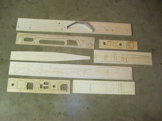

One of the more popular wood Q-500 kits is the Hurrikane.
The fuselage kit and and landing gear are available through Super T RC:
http://www.supertrc.com/results.asp?category=10
I downloaded the plans from the following:
http://www.supertrc.com/download.asp
The pictures shows what was purchased from Super T RC.
ID:	1682648   Click image for larger version
ID:	1682649   Click image for larger version

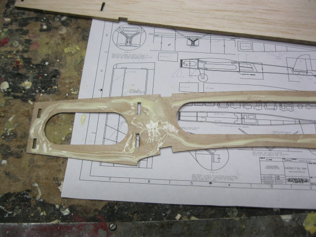

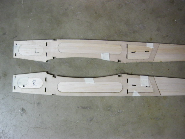

I typically build a couple models at the same time.
I am also building a Venom fuselage. This is a HurriKane with wing cut outs for a Viper wing.
The plywood doubler is attached with wood glue.

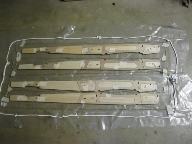

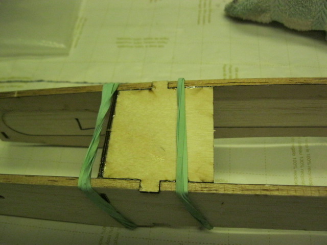

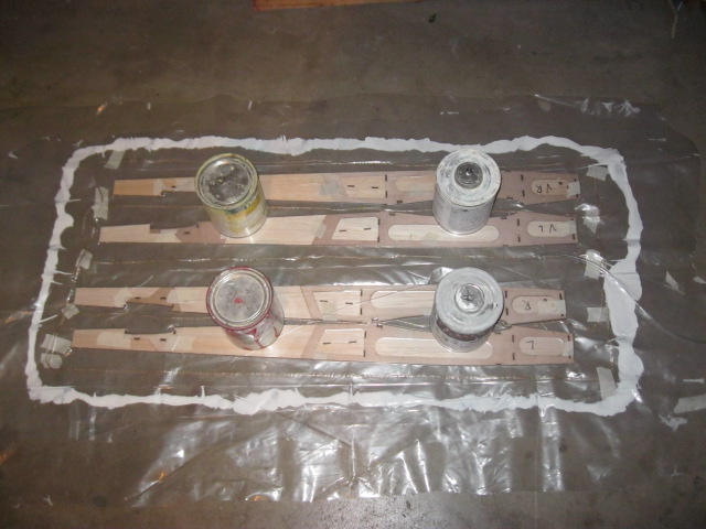

I vacuum bagged the doubler to the fuselage side.
This is strictly optional, but it insures the parts are held together until the glue drys.
Some twine was routed around the parts. The bag was joined with latex caulking.

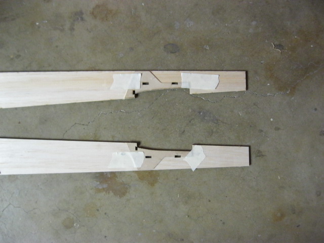

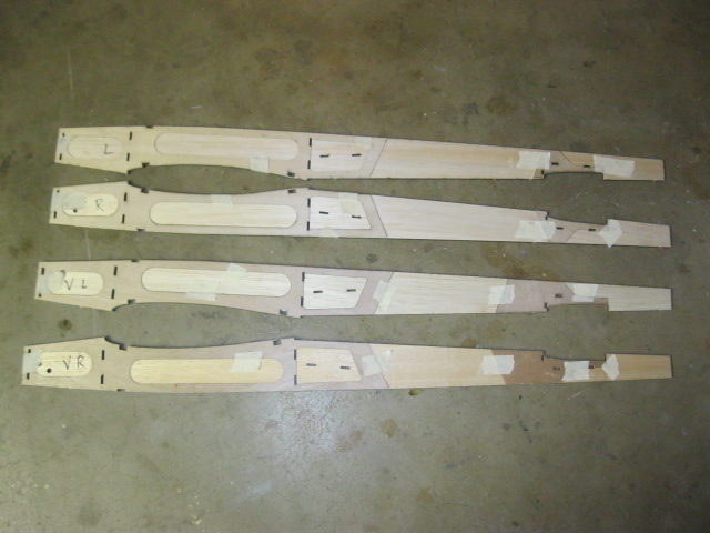

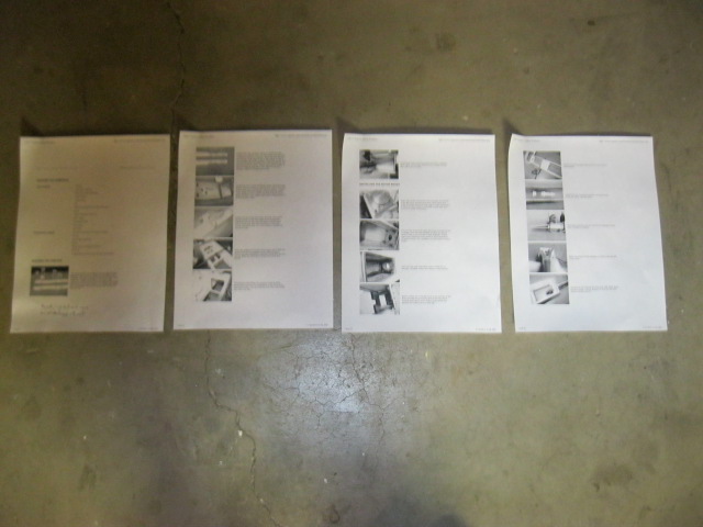

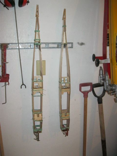

Things were slow around the house so I framed up a couple fuselages tonight.
I began by printing off the instructions from the Super T web site. Tonight's work covered pages 1 to 4.

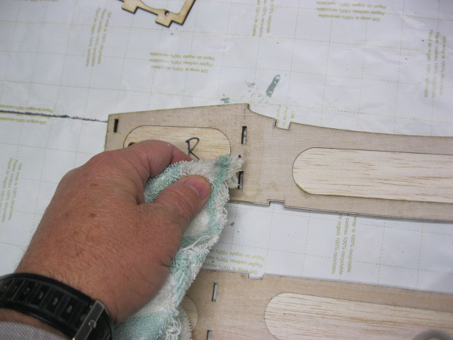

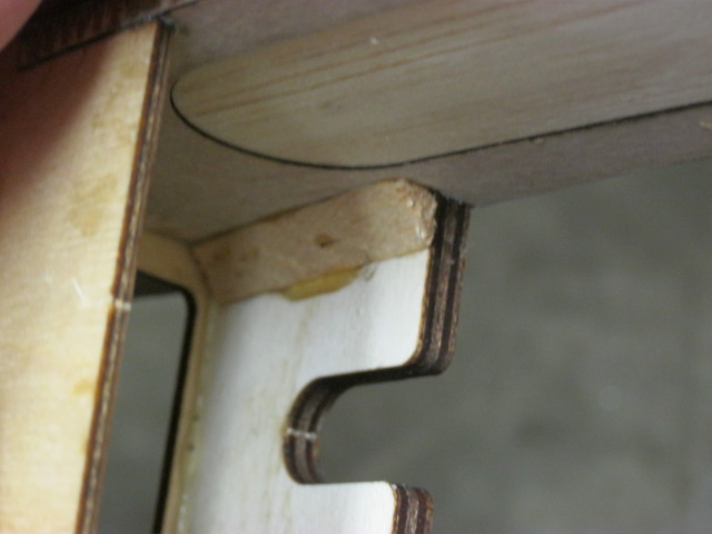

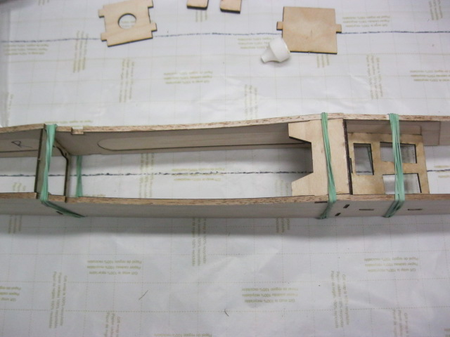

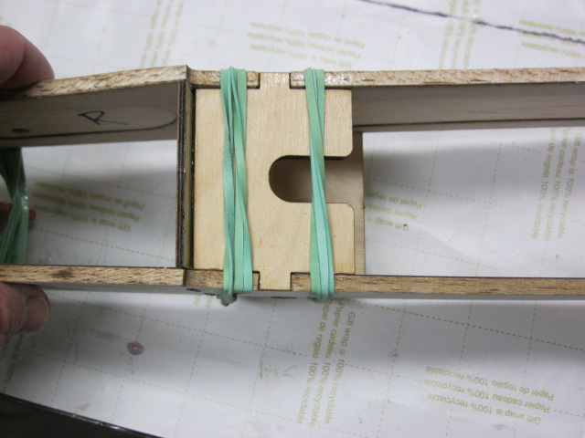

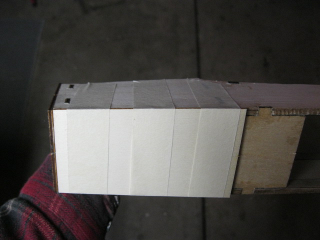

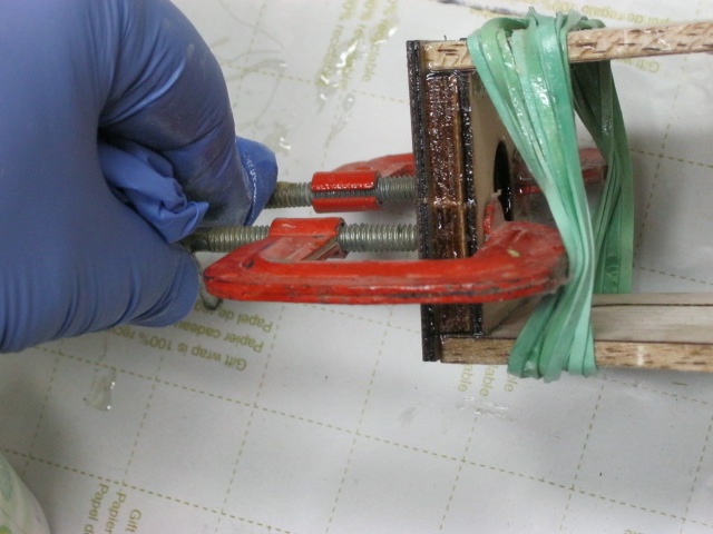

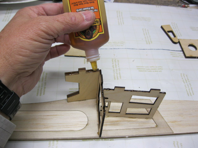

After breaking the parts free you dampen the sides with a damp cloth. The water activates the Gorilla Glue.
A thin bead of glue is placed around the edges. Parts are inserted in the laser cut slots.
The parts fit very well.
The instructions recommend furniture clamps holding parts together. I didn't have any so I used some rubber bands instead.

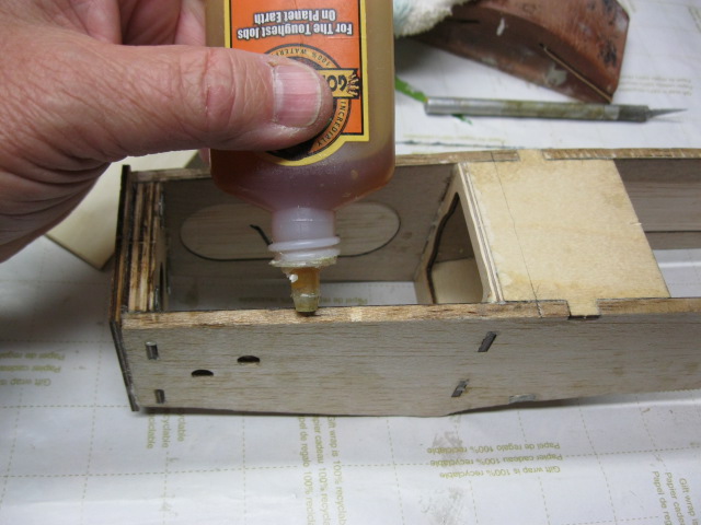

The instructions did not state what glue to use on the firewall. I used epoxy on the model shown.

The first fuselage took me about 1 1/2 hours to frame up.
I set it out of the way to dry.
The second was done basically the same way. This time it took about 1/2 hour to do the same steps.

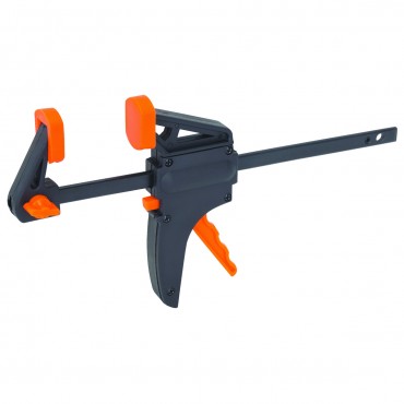

ORIGINAL: sahartman21
These are the clamps that I use. Harbor Freight often has them on sale for $2 each. On the other hand, rubber bands are cheaper and work just as well.

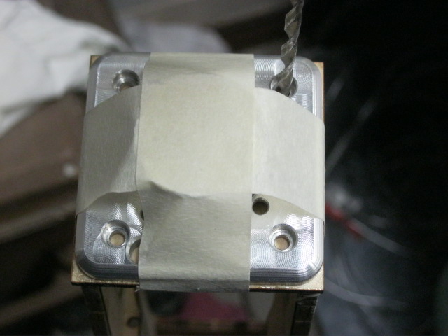

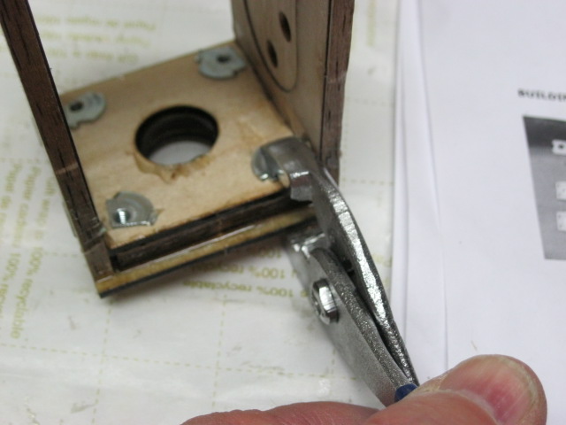

Tape the motor mount to the fuselage and drill holes for the blind nuts.
If you use the large hub blind nuts, you will have to cut some of the blind off.
These were pushed into the firewall with a pliers.

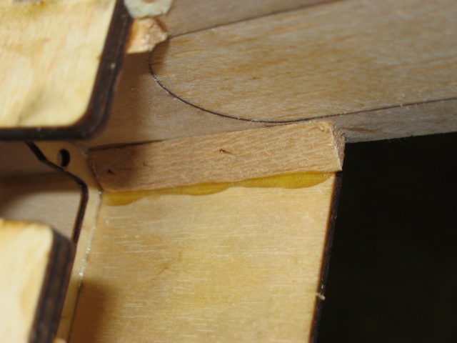

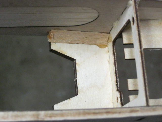

Some 1/4" balsa triangle stock was glued in place at the wing hold downs and landing gear block.
