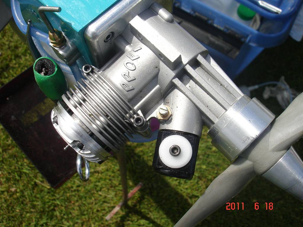

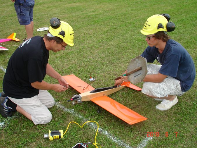

Old 12-21-2011 | 05:55 AM
Posts: 7,816
Received 10 Likes on 10 Posts
From: Upplands Vasby, SWEDEN
Default RE: Getting started in pylon?
Hi!
Agree fully!
The best way to learn how to fly pylon racing is to jump in and race!
