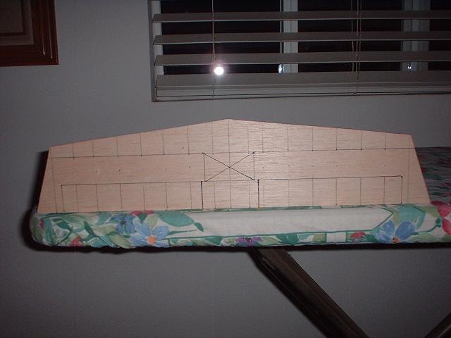

Posts: 1,987
From: Apple Valley, CA
Default Sanding the V tail
If you will note,,, The "X" in the box is the area that should not be sanded on. Thats also the place to put the "bubble" on when setting Tail incedence.
The other lines are used as guides while sanding
BV

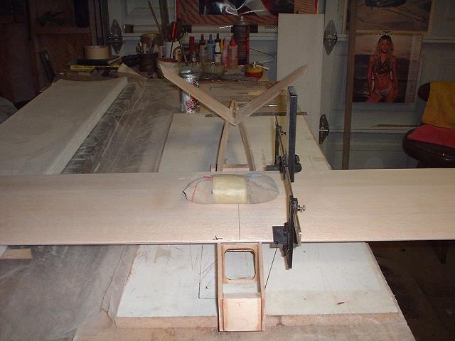

Old 01-24-2003 | 07:01 AM
Posts: 1,987
Default V Tail setup
I put this plane sorta together these last few days,,, inbetween making kits,,, to help out those with questions on how to use the "bubble method" when setting up the V tail
BV

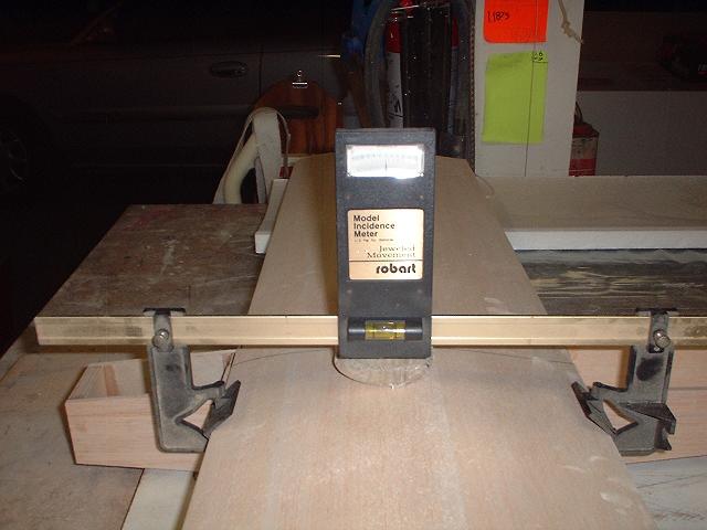

Old 01-24-2003 | 07:05 AM
Posts: 1,987
Default Incedence Meter
Here's a pic of the Robart Incedence Meter on the wing.
I prefer to use the bubble here vise the meter to keep consistant with the V Tail bubble
BV

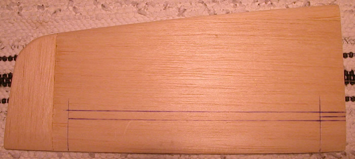

Old 01-24-2003 | 11:14 PM
Per_N's Avatar
Posts: 207
From: Stockholm, SWEDEN
Default Daven
Yes, I see that is fiberglassed already but I thought it should be possible to something trow the glass. I hope he post a closer picture.
I post a picture how i have marked up mine. I wonder a bit how much the distance must be between the edge that is against the other tail and to wards the beginning of the rudder. And also if it's critical how long the rudder is.

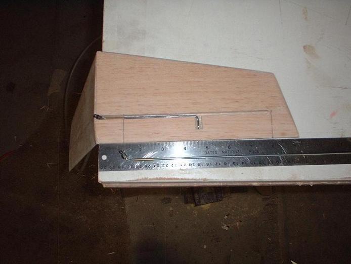

Old 01-25-2003 | 05:03 AM
Posts: 1,987
Default Elevator Torque Rods
All thats left here is to epoxy in the Elevators Torque Rods and cut the ends
BV

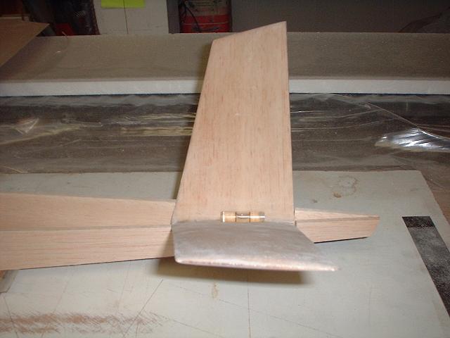

Old 01-25-2003 | 05:06 AM
Posts: 1,987
Default Another Veiw
All most finished,,, just needs a finish sand job and its ready for some Polyurethane paint
BV

Old 01-25-2003 | 02:05 PM
Posts: 72
From: Indianapolis
Default Interesting
Bill
Thanks for the great Pic's. I noticed the torque rod is actually in the groove (as opposed to slightly recessed in the elevator itself)
Approx. how wide is the groove to compensate for the potential bind on the down elevator.
I use very little down elevator on my setup, so perhaps the potential binding on the down elevator is a non-issue.
BTW, are you going to Phoenix??
Mikey D
Old 01-25-2003 | 04:11 PM
Posts: 1,987
Default The "groove"
Hi Mikey, the groove is approx 3/16 wide and the TQ rod is 4-40. So binding is not a problem,,, so long as you keep the groove a little bigger than the TQ rod.
YES! I plan on Phx also,,, I need to collect some more "coldies" from RB
