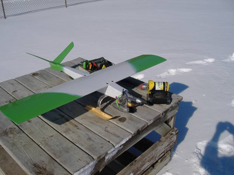

it flew, really.. I saw it. No trim needed. I hope he remembers to ditch the skis come April.
what's it made of ? how does fast does it go ? how much does it cost?

Wish I could have gotten up there sooner to see it. Missed the Chili.
Nice day considering the date.
It does need a name................

How about QE3, with that skid under the tail it looks like you could steer a boats with it. LOL
With the ski's on it how about "Pole'er Bear"
Good looking plane, no matter how many BAD jokes we come up with. [sm=thumbup.gif]

That's my first attempt at a molded fuse and tail.. The molded wing is off an R-200.. Splatt is correct, no trim on the first flight and just throw adjustments for the second flight..
I'm not sure why I did the sub-fin but by the time I thought maybe I should not use it I was too far along and didn't want to have to start over again on the plug, I had done that twice already this winter..
I've got one in the mold last night waiting for the NASCAR race to get started.. It's the first one I've painted in the mold so I'll shoot some pics of it if it turns out.

Is that a Conspirator fuse From ARC??????
Old 02-27-2008 | 02:23 PM
Posts: 8,456
From: Waseca, MN
Default RE: Lee made a plane. It needs a name
Do you mean conspirator? It did have a similar tail skid??

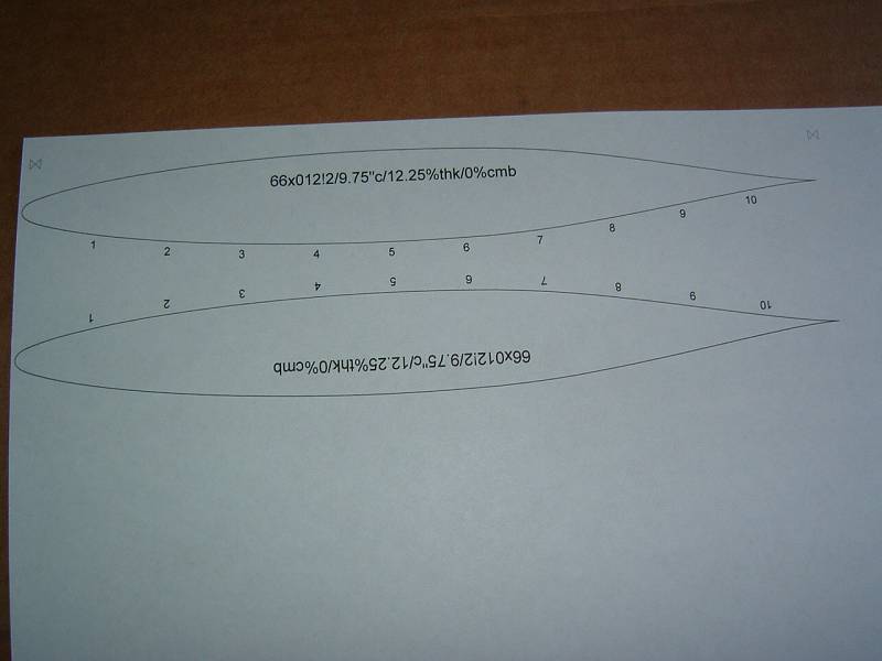

I am confused, my r-200 wing is not a 66-012?

Well, assuming the Bird of Prey wing and the composite Seeker wings from Super-T are 66-012, then no. The incidence is off by about 1.5 degrees and I have to drop the TE about .125" to get to zero.. Could it be that the slight difference in chord causes it to be off?

The cord on my wing is 9 7/8", Seeker and BOF is 9 3/4". But the R-200 wing is a 66-012.

I don't know what to tell you.. I used a BoP wing to pot the saddle of the plug but when I put the R-200 wing on there the TE was high by about .125"..
