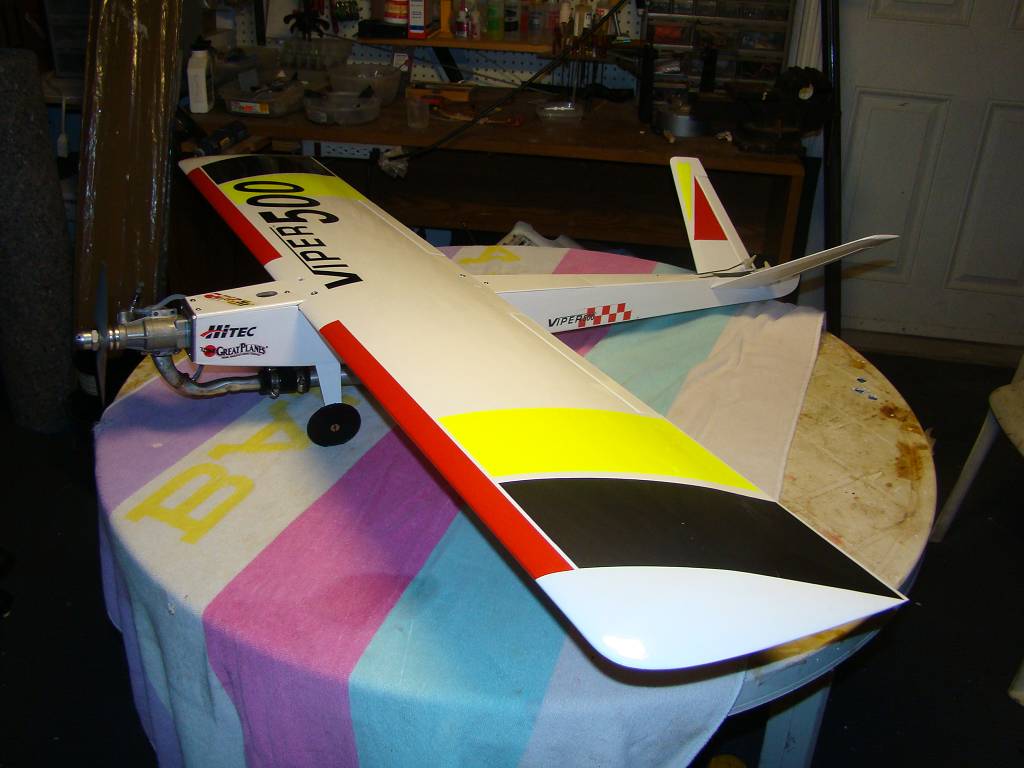

thanks guys. I won't be clipping wings. This is my first viper / fast plane except for warbirds. Which I thought was fast. But these are another world... Landings are taking some beatings..

thats a good looking color scheme! i like it!
