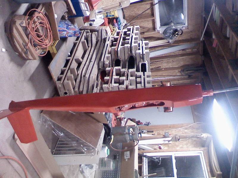

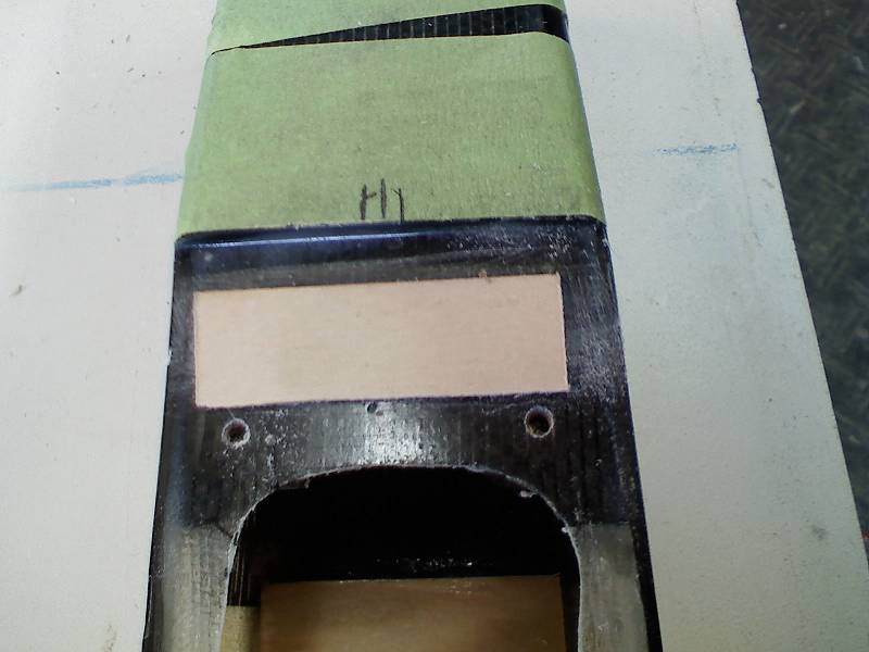

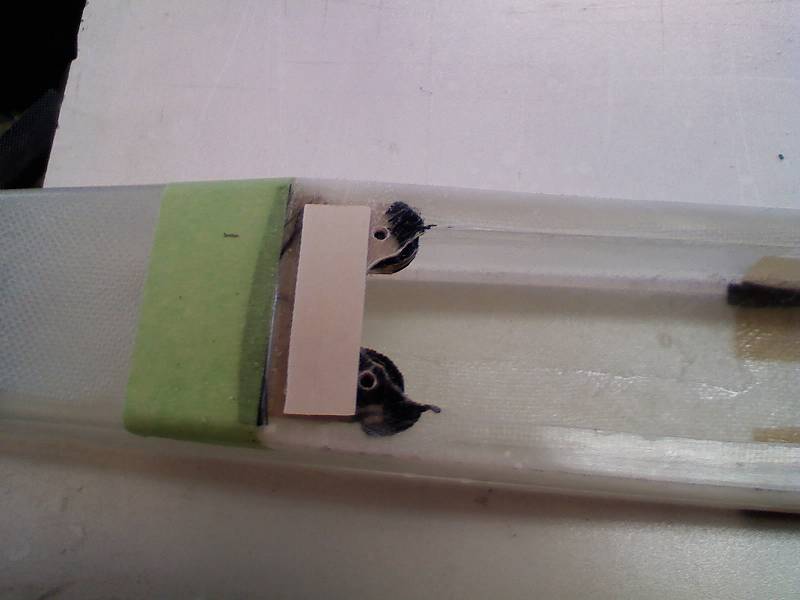

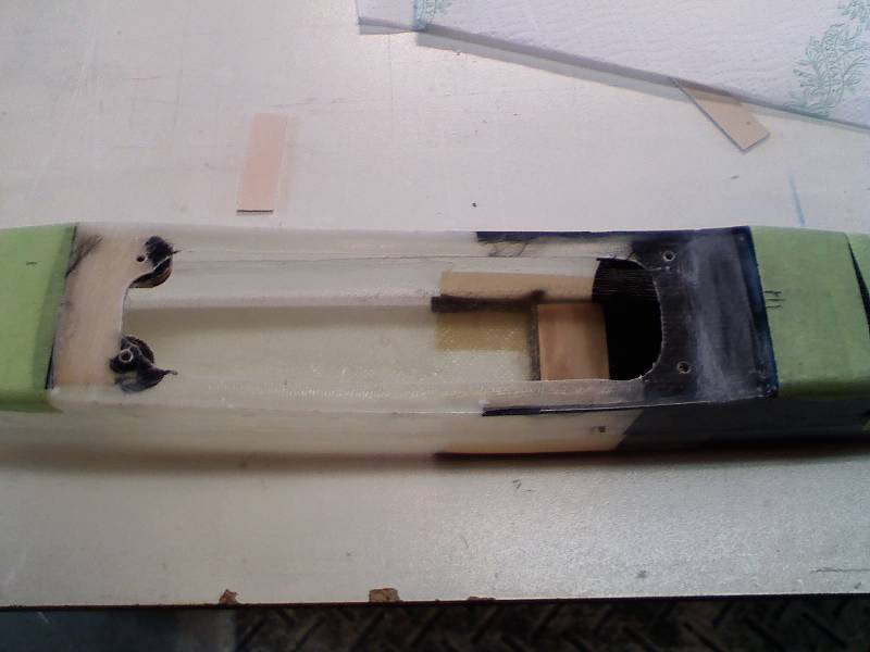

I try some thing new. I wondered how hard it would be to place a viper wing on a Mad Dog Fuse.
It needs 0 in the front and .125" in the rear with the wing all the way forward. And just mud up the wing saddle with Microballoons and epoxy.
I'm thinking of redoing a Mad Dog and make a new fuse mold if any one wanted one?

This took me all of 15 min, And now on to the Microballoons and epoxy

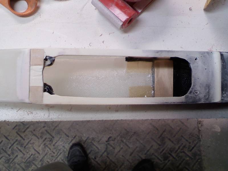

Hi Guys
It needs 0 in the front and .125" in the rear, with the wing all the way forward.
I put a a pro smart level to check and this is what it needs, now I can mud the wing in.
Pic to come later.

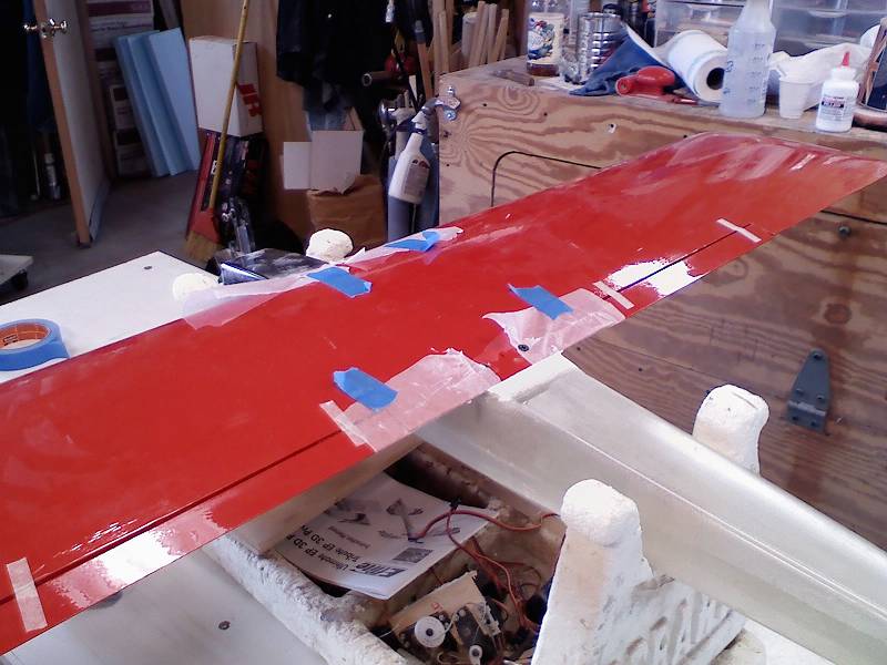

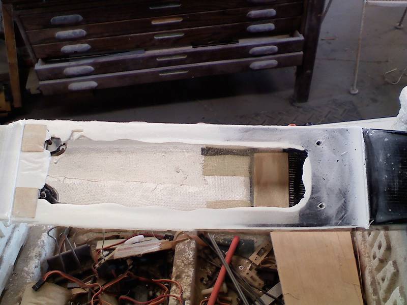

Here is the new pics

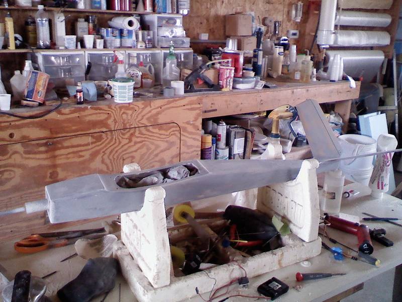

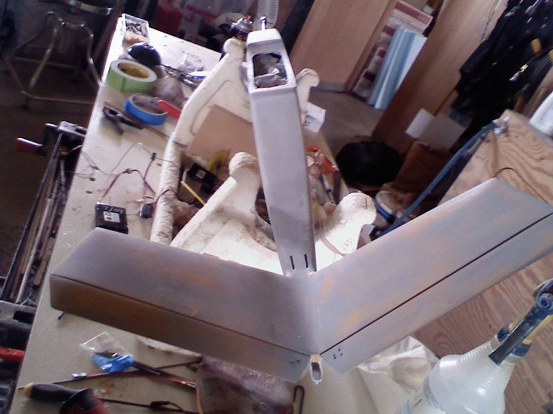

Here is adding a reused old tail. and Prime painted

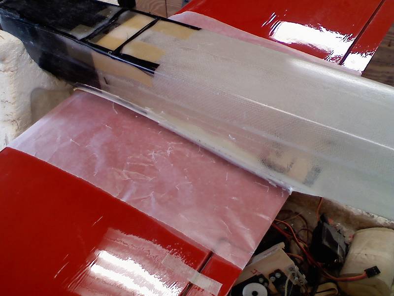

And painted Red to match the wing. Will fly it at Caps race this week end

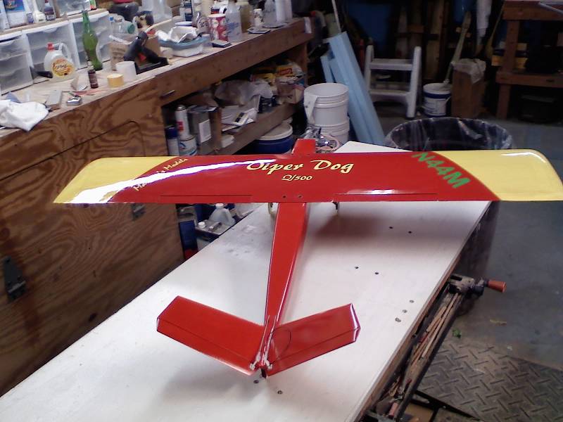

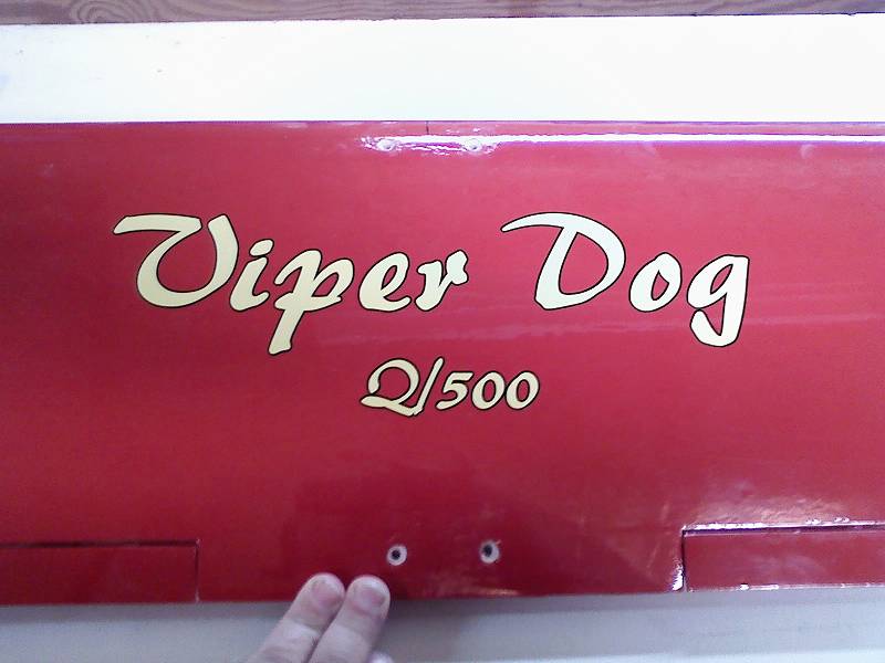

Here it is done. the weight is 1/2 of a oz over.

Went to the field to fly today the Viper Dog. Started out with a 0,0,0 degree airplane. Guess what happen??
It flys 0,0,0 Thats it no trim what a great set up. See you at Tom Scott  Race!!!!!!!!!!
