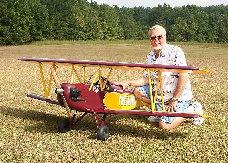

Here's my Balsa USA Fly baby Biplane (33% scale) covered with yellow SolarTex and painted with maroon paint.
I had applied a coat of clear water base polyurethane over everything to give ir a bit more shine .
I LOVE SolarTex!!!

[X(] Wow, that plane is very attractive. Nice work Dick, from the picture you did a very good job.
