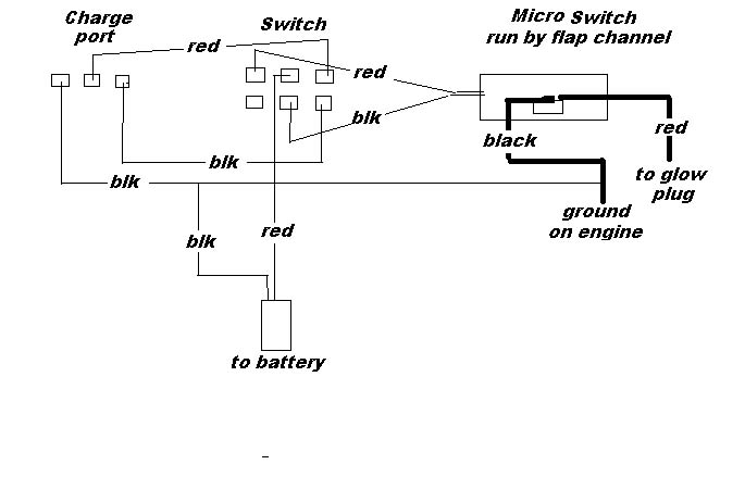

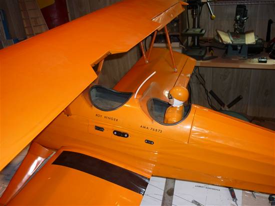

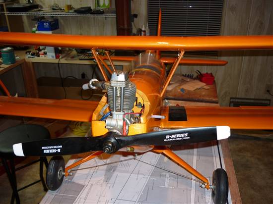

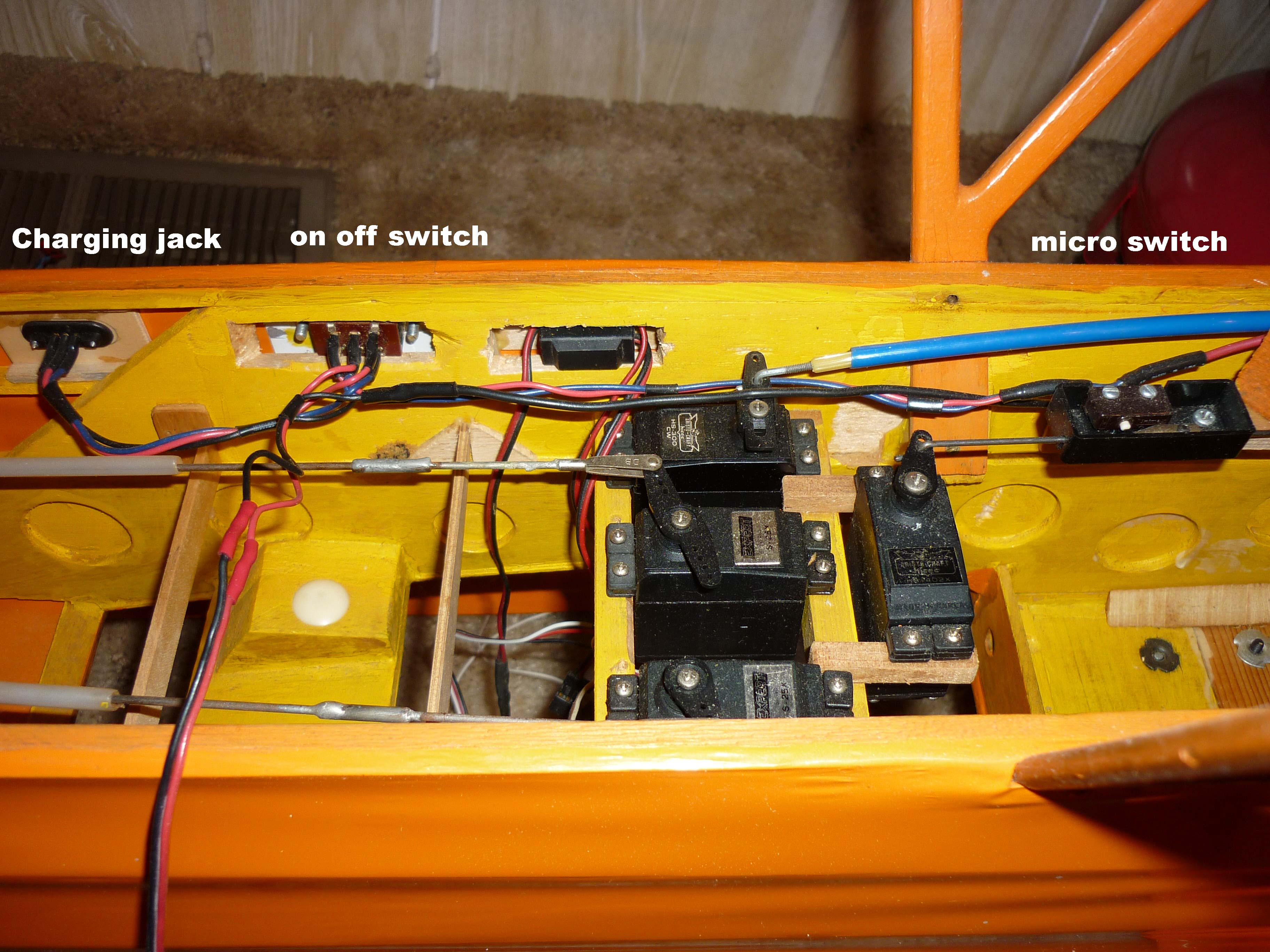

Bought a plane from a non flyer. It has a on board glow driver set up in the plane. Not sure if its a standard set up or his own "Rub Goldburg" type of thing. The guys dead so can't ask him. Any help will be appreciated. Also does anyone know what that charger outlet is .
That charging plug you pictured is a three conductor deans and it will tell you nothing about any manufacturer. It comes from a time when deans were popular for modeler to use on all their equipment. Even replacing the hodge podge of different manufacturers plugs on radio systems. At on time their was a hugh variety of plugs in use.
That on board system is simply a switch and is not a modern on board electronic system. Is there a need? In most cases you are better off learning your engine better and on board glow is crutch that will only cause problems.
I hope the battery that the schematic refers to is not the RC system battery.
I have not seen an Aristocraft or Expert servo in use in many years Are they three or four wire servos and what kind of plugs are in use, You are bound to run into problems there.

Seconded. Those servos aren't likely to still be good. Give the airframe a really good going over too. Glue can loosen up over time and that one has been built for a long while.

John...gotta disagree with on this one....an on board glow is nice for an inverted 4 stroke programmed to come on at 1/4 throttle or less. Of course thos is not a programmable on board glow.....
If the engine isn't mounted inverted I'd remove it if you can get to the glow plug....

No problem JM and I'll bet we may not disagree all that much. Yes there are certain times, certain engines and certain mounting orientations where the added weight (an additional engine battery pack for the glow) and complexity plus the need for additional charging requirements every outing may be worth it.
But my observation is on board glow is is just like flapperons. The fellows can,t wait to get it even when they are still learning on a trainer they just got to have it. That too is a crutch and folks tend to want to use it that way and of course that is a dead end that only leads to crashs early on.
On board glow can and will cause crashs or at least does nothing to prevent flame outs when used carelessly and in lieu of good operating and tuning procedures.
Another parallel thats certain to get me in hot water are flight box power panels for folks operating glow powered aircraft. These are promoted by the press and industry everywhere you look and truth is its just uneccessary fluff that every new flyer just has to have.
So any way I do agree there are realitively rare times a need for on board may arise but I beleve in most cases its counter productive to use them.

I do agree with John and the on board shown is not modern at all, it's how we did things before the industry decided to come out with different types as electronics got better. Every once in a while I will still make one up for someone like that, I find my home mades are better then the store bought. It's just a micro switch that goes on and off with throttle servo contact and you can set it {program it} so it goes on and off any place you like. No electronics to poop out on you! I agree with John that on board systems are not required in most cases, a well tuned and set up engine doesn't require them. I did try to install one of the Expert systema in my pattern plane but it was because of the cowl being in the way of my inverted engine. The Expert was a junker and only worked once in a while and if it was real close to the engine so I just installed a remote glow driver. {home made} The engine is tuned well and set up correctly so as of this date I have had no dead sticks at all. A required item?? Nope but they are sometimes a nice thing to have, just not very often. I see too many of them having problems at the field.

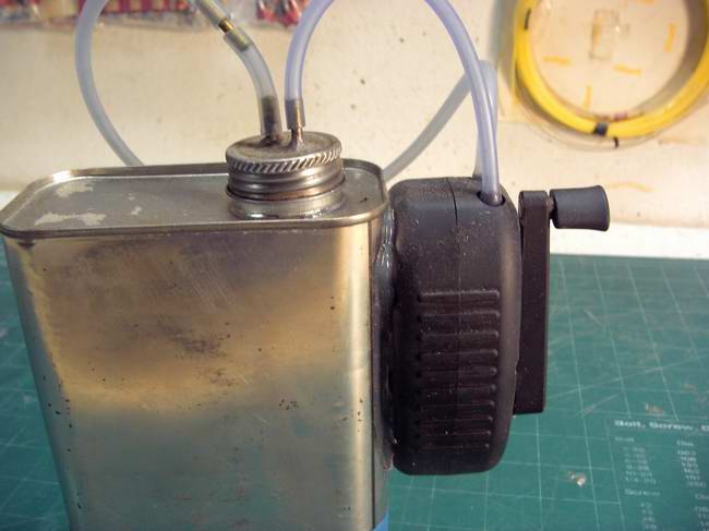

I do like my power panel though. As john mentioned not something required but I still like it. All mine is used for is the electric fuel pump installed inside my flight box. This time of year I can get a bit more juice to the glow plud then my glow stick puts out, that helps a lot with some of my long wired remote glow drivers but that's about it. I could do away with it and not miss it at all but I'm set up with one and like it.

John, I have one of those electrics on my gas can and one in my flight box just in case my old stand by flight box pump goes out. I bought it used 15 years ago in another flight box that also had my power panel installed. I have a burnt out battery in my new flight box so for the last couple of years I use a car jumper to power my starter and have two wires that go to the power panel to operate my pump. I did go to Harbor Freight looking for those 18 volt batteries for my starter but they didn't have any in stock at the time. I may down size my flight box in the future and just go to the hand pump and glow stick but for now my rolling box is loaded with STUFF. I need the STUFF so I always have the box and the panel is installed in it. I'm the guy that everyone comes to when they need STUFF they don't happen to have. I'm at that point in time down sizing may be a good option. Until I do that the power panel is with me, not really needed at all but it does come in handy during the cold season.

Thanks guys for all your advice. You all have confirmed my suspicions about all the electronics in the plane. I’ll replace all the servos…. Eliminate the on board glow driver seeing my 4-stroke is mounted upright. And carefully inspect the airframe. Again, thanks for all your advice. Maybe someone now can tell me what the plane is.
