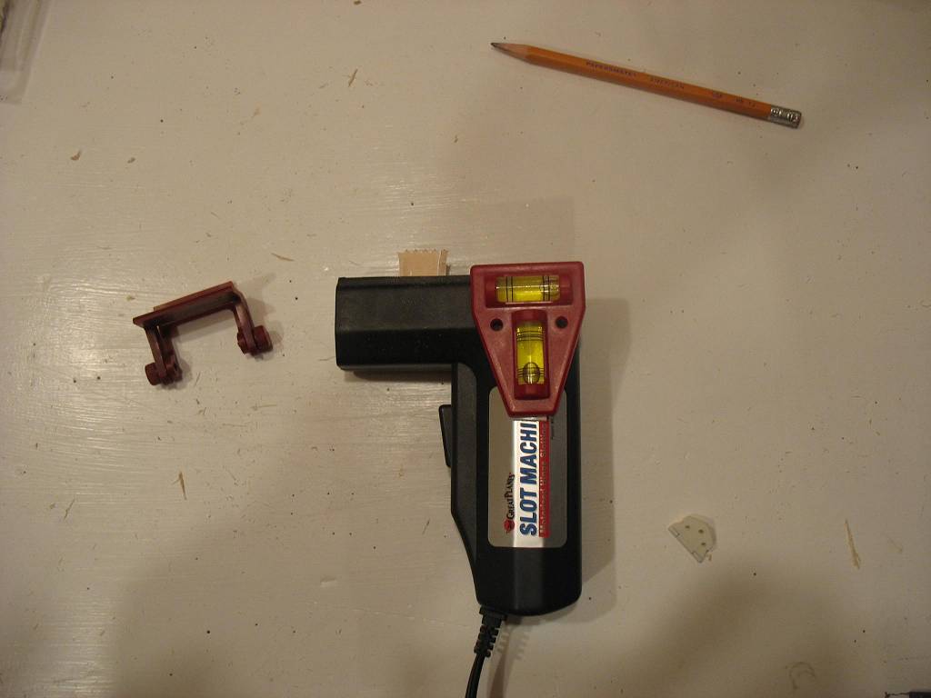

I just got the GP slot machine tool. When I did some practise cuts, it seems I would cut off level. My bench is waist height and I am tall and I just seemed to angle the machine while cutting. Photo was my solution but I am wondering if anyone has a better approach/technique? I just got the level from Lowes and stuck it one with 2-sided tape. The horizontal one is tough to set because the machine front is tapered but the vertical one helped me a bunch.

for me it was just practice, cut some pretty ugly ones to start but before too long, they were just fine! Keep after it, you're gonna love that thing!

ditto................funny thing is, i am a millman by trade (a real cabinet maker) and i thought i was gonna ace the use of this tool right out of the box....LOL.....takes a bit of gettin to know it, but once figured out from test cuts, i'd never do without it.
i've used the guide, but found that by using a scribe and starting a groove in the wood where i want the hinge and then freehanding the SM into the groove worked a lot better.

I was cutting triangle stock (all surfaces are triangle on both sides) so scribing was hard.

I didn't like mine at first..then I got better with it..I like to scribe a center grove and then mark the spot, and freehand it, no guide.. Seemed to work best for me..my main issue is the start ...get yourself positioned with the slot surface pointing up...I brace myself so I won't be wobbling. Then I turn the tool on and let it just barely kiss the area to be slotted, once you get an initial cut going it seems to track down well. I have always had a fairly good eye for free handing things so possibly you might prefer a guide of some sort...

I just got one for Christmas and had some trouble at first. Scribbing angle stock was my biggest problem, so I trimmed the point off just where the hinges go to about 1/16" wide and it made the scribbing easier.

Use both hands and go slow. Works good.

I've used that tool- a buddy had one. Here's what I prefer for slotting. I modified mine by alternately bending the teeth a little.

I use the guide with mine, no trouble keeping the slot straight. If I can do it with my shakey hands anyone can. The guide can be bought at most hobby shops. I think there is another thread over in kit building about the slot machine with different photos of A COUPLE OF DIFFERENT GUIDES YOU CAN BUY.

There was an article in Model Aviation some ago on how to build a guide-platform for the slot machine. It's not to hard to make, and makes chore of cutting hinge slots much easier.

I found that scribing a path for the blades to follow helped a bunch. This can be done either before or after the surfaces are covered. If covered, make a cut with an Xacto blade and then scribe a line in the balsa. Then, and this is the important step, hold the Slot Machine so that only a corner of the blade is touching the scribed line. Start the cut with just the corner of the blades and as it bites, rock the tool so that the blades are flat against your surface and lined up with your scribed line. This will keep the tool from dancing or bouncing out of your scribed cut. It took much longer to type this than to actually do it. After you use the tool a few times, this is all one motion that takes only seconds to make a perfect slot.
