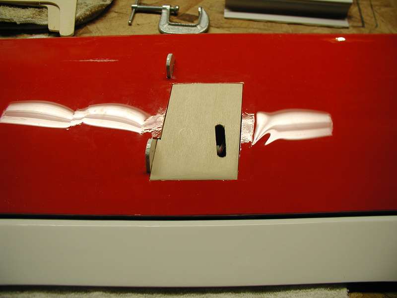

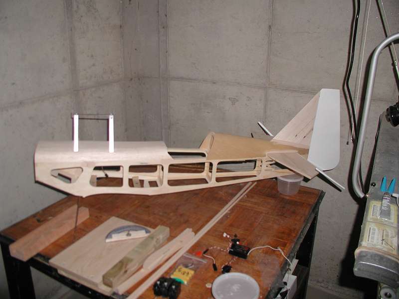

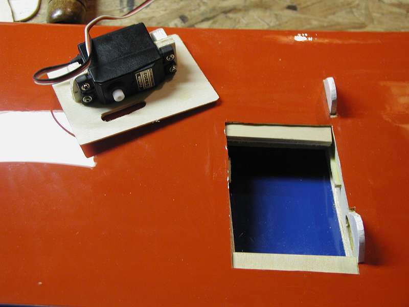

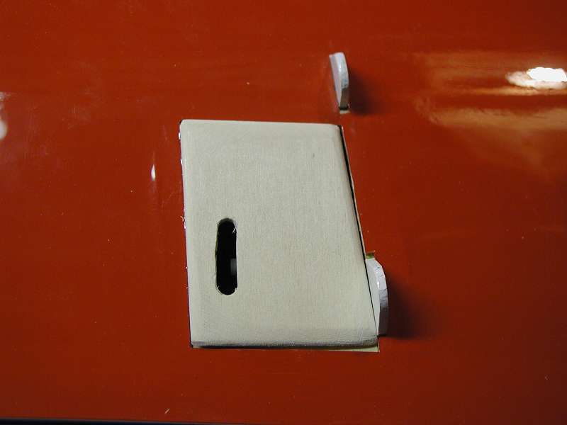

John et. al.,
Thanks to all who responded to this forum question. I have made the necessary mods and have mounted Futaba 9202s in each wing. They do squeek in and I was able to get away with only cutting in from the top so there was no covering patching to do. Here are pics of the finished hatches (pre-covering) and a pic of the fuse bones. Still on a hunt for an OS 1.08 w/pitts @ a reasonable price (<$200). Got any leads??
