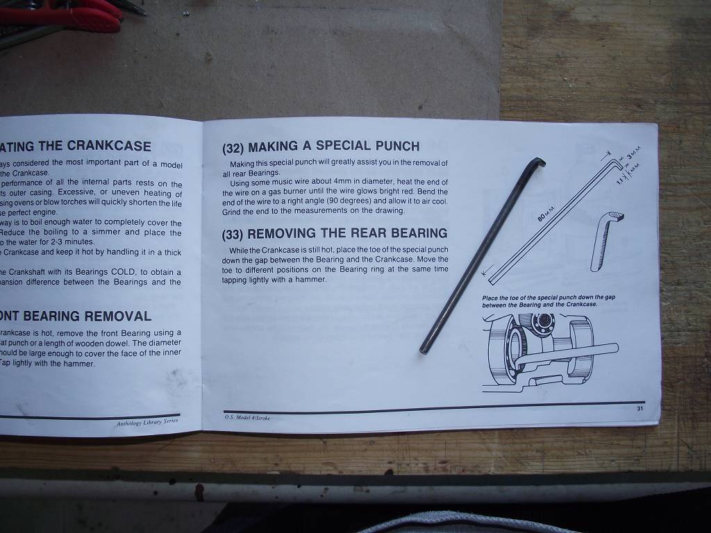

What kind of removal tool do you use for the bearings? I had an engine once that wouldn't let the thing go with heat and I wound up grinding on it and yanking it out. Engine ran well afterward though.
Old 03-08-2011 | 10:16 PM
My Feedback: (-1)
Joined: Apr 2003
Posts: 14,400
Received 9 Likes on 8 Posts
From: Hemderson, NV
Default RE: A question on engine rebuilding
Just a little home made tool made from piano wire with a short tapered end. I can usually get it into the little groove between the case and bearing then just give it a yank. Doesn't always work. It was something shown in a very old book on rebuilding OS four strokes I have. In this case tonight the engine was an OS .55 and the case was broken in a crash. My friend finally got tired of fixing it with JB weld and bought a new case. Before he went home it was decided to give it one last try. I used my small hand torch and heated the case on the outside at the bearing area and just below. One good wrap on my building board and the bearing just fell out. It took the torch, I usually just boil the engine in water and give the bearing a slight tug and they come out. This one was really in there. I really cooked the case, heating may be an understatement.

I made a handy tool for removing stubborn rear bearings out of a cheap screwdriver.
I took a std. flat blade (about 1/4" wide ) screwdriver, and bent just the tip (1/8" ) over 90 degrees. Then I ground it thin enough to catch on the inside edge of the inner race of the R. bearing.
Put the case on a block of wood with the front bearing opening pointing straight up. Heat using your favorite method...and go down in thru the F. opening with the tool. Catch on the lip of the inner race w/ the bent over edge of the tool, then tap gently but firmly w/ a light hammer. Reposition the tool between taps so you don't get the bearing cocked in the bore as it's driven out.
This method has never failed...

That's what I have only made out of a piece of piano wire. Last night when I was working on the .55AX the problem was there was no lip to snag onto and the bearing was seated flush with the case. Some nice maching in there. Anyway, the tool is what I usually use but I do wonder if perhaps the service centers don't have an expanding tool of some type??Just wondering but the real question was about an easier way to remove the connecting rod. I have worked on some engines that seem to have more room so they just pull right off and some you just swear at until it comes off. Seems the swearing thing is used by most everyone.

I disassembled an old OS FS-40 last night that I just bought, but I haven't been to take off the bearings yet. Could you guys post a picture of the tool that you use to remove them. Thanks.

Tool and book. The book of course is geared to the older engines but other then a couple of very minor things the engines are still pretty much the same. These little books were what we used to buy before computers became the rage.

I just read the how to make part and I wanted to mention I didn't heat the music wire. I bent it in my vise like I was bending landing gear then I cut it off at the bend and ground it to shape. Heating it removes the temper in the steel.
