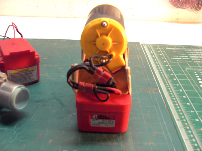

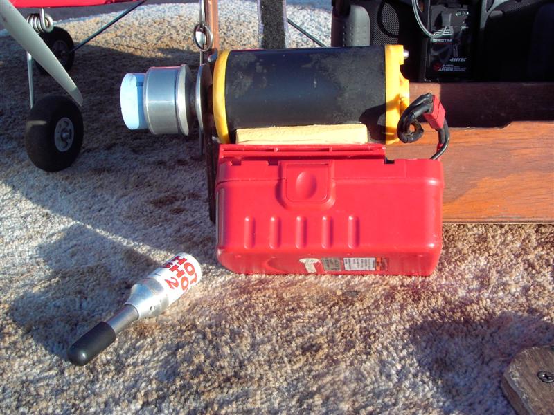

Old 03-18-2011 | 10:01 PM
JohnBuckner's Avatar
Posts: 10,441
Received 11 Likes on 11 Posts
From: Kingman, AZ
Default RE: Starter Problems with Saito 100
Those are the ones will turn any whimpy cheap starter into a tiger. Virtually everyone uses that battery at our field now.

Ken you can use any modern smart charger i.e. ones that auto sense voltage. and I charge at a c10 rate.
The actual chargers I use are the same three that I charge everything with including 1.2 volt ni starters. They are two Pro Peak Prodigy 11 and one Mystery charger the mystery is a fifty buck unit that was what HK sold before the BC6 or whatever they call it now.
The cells in the ten dollar battery are 1.2 Nicds and they work great for perhaps no more than two day. This battery offers Voltage and I have always said when it comes to starters, voltage is king. If the fellows want a battery that lasts for weeks this this is not for them, ya gotta charge it.
We are just now over forty members and becomeing even more active than ever and since I first discoverd this ten dollar battery over half of our member have made simple conversions with it. Thats because its the best bang/performance for the buck.
I no longer use the 16.8volt conversion I have used for years which were excellent performers but the conversion was difficult just attaching two seven cell Nimh packs in series and though up to 5000 Mah with some that setup was quite expensive.
The simple act of attaching this Harbour Frieght battery is so, simple that last one I pictured look close. That is just a block of balsa between the battery and the motor case. I carved a concave surface to fit the motor and the battery side is just flat. There is nothing holding the assembly together except RTV or silicon seal (takes twenty four hours to fully set before handling). There is no strength issues with using the glue (do not use epoxy, that is too brittle) I have dropped mine wheelchair height to the desert floor to many times with no bonding issues.
I also do not use Lipo because the issue with others constantly borrowing your starter. There is no way to convienently keep track of you batterys charge status an avoiding a deep discharge which will destroy that expensive battery almost instantly. Also if one choose to use the three cell lipo you are stuck with even less voltage and a starter that is going to be even more whimpy that the old twelve volt cell holder that folks are even still buying to this day.
John

For a standard starter there isn't any problem running 18v through it? Can anyone post pics on how it's wired? The last picture posted I don't really understand what is being charged there. Also, it seems like it would be heavy to hold the starter plus the big battery in front of the engine. I'm just thinking that you don't want something cumbersome in your hand in front of a Saito 150 when it cranks up!
Old 03-21-2011 | 07:12 AM
Posts: 10,441
From: Kingman, AZ
ORIGINAL: Gringo Flyer
No there is no problem with using the 18 volt battery with a cheapie starter however much more voltage and you force a hydrolocked big fourstroke what will happen on some brands is the contactors in the switch will weld together or become interminttant. This happens in the switch not the motor.
I think I have convertered over ten of the them now for the fellas in addition to my own starters
Some of these cheapies have tiny little points on the switch plates and these are the ones that can have problem if you go over 18 volt and force locked engines.
We are approching almost a hundred percent of the actiive flyers using various combos with this battery. There is a reason for that: Its cheap, it is not difficult to handle, it works well for a wide variety of engines if not all, its super simple to convert and most of all working together with geared manual pumps on the fuel can and pocket type ignitors it eleminates redundant, expensive and dangerous power panels with big batterys in a flight box that is so difficult to lug around.
Gringo Flyer the wiring is as simple as can be. One wire with two conductors comes out the back of your starter. There are two blade connectors on the battery. All you need to do is connect each of the conductors that come out of the battery to the two blade that are on the battery. Solder or use a female blade crimp connector what ever.
If your motor spins the wrong direction you simply reverse the two leads from the starter to the blades on the battery.
Any manner of additional plugs can be installed to connect to a charger or simply use alligator clips whatever.
