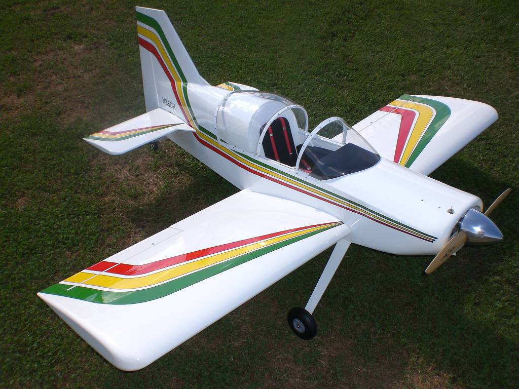

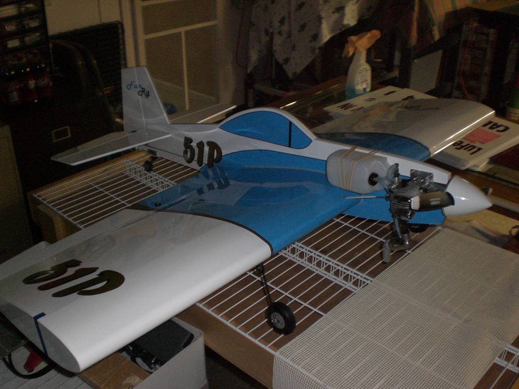

I use a vacuum with a brush head and vac the entire airframe just before I use a good quality tac clolth and then cover. I have substituted a paper towel lightly sprayed with Windex. Need to be very careful doing this though because paper dust can ruin a great cover job!
