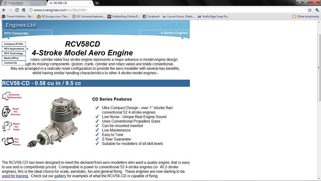

I've nearly finished building a T67 Firefly, semi scale RCplane but theground clearance for the most suitable prop is much too small.
My idea is to use a three bladed prop!
Has anybody used a three bladed prop in similar circumstances and if so was there sufficient power.
I have a 4 stroke RCV 58 CD engine.
Thanks.

Something like an 11x5 or 10x6 3 blade is fine.
As a general rule if you are using a 11x6 2 blade and want to go to a 3 blade you either drop one in pitch, to 11x5, or 1 in diameter to a 10x6. A 3 blade is scientifically less efficient but it is hard to see the difference.
These are as small in diameter as I would go. If there is still a ground clearance issue in these sizes try changing the wheels. It may be a decent idea to go with slightly bigger wheels anyway.

The props sizes I posted are within the range suggested in the engine manufacturers manual for a 2 blade. In the manual for the engine itself they suggest an 11x6 or 12x6 apc type 2 blade prop.
I would trust the manufacturer knowing what is ok for their engine. From the manual
I would not post them without first researching what the manufacturer suggested themselves for the engine.....

PROPELLERS
The RCV58-CD engine uses conventional sized propellers. •
sizes of propellers which could There are numerous different
be used and this is really dependent on the airframe and the type
of flying.
For general running in etc, RCV recommend an 11 x 6 or 12 x 6 •
APC type prop. These propellers give a good all round
performance
of flying.
performance

created a bit of interest with this problem. I have the manual and bought the 12/6 prop after reading a test report on various prop sizes, but my problem is that if I fit a 12/6 the blade will be grass cutting at zero ground clearance.
The RCV58 CD has a gear driven shaft and is 1:1 and will take conventional size props. It has no poppet valves or springs.
I think a 10/6 will still not give me enough ground clearance and so I thought a smaller diameter 3 bladed would do the job.
At the moment I haven't seen any small diameter 3 bladed props for sale but I spotted "sports props".. 2 bladed 7 inch diameter with a big 7 or 8 pitch. This type of blade has got me thinking again.. I wonder, could I use one of these ??

You can use any prop that keeps the engine within it's working RPM range. The RCV I installed was the SP model and I have no real idea of what prop sizes would work on it. The instructions tell you what props the designers found to work within that rpm range so they give you an idea or starting point. Most normal four strokes are run well below there top RPM range to keep the valves from floating, that's why you see bigger props on them. I have a box of different sizes of props and I test all my engines to make sure I don't over rev them then I test to see what prop size I, the pilot likes on the plane/engine combo. A 7 or 8 pitch isn't very big. Some of my engines in a pattern plane are calling for 12 to 14 pitch in a shorter prop. That's why I said to go into the glow engine forum and talk to people that are really using these engines. You may over rev your engine with that small of a prop. If you contact RCV directly and tell them your problem they may have a much better answer for you. I'm sure there are forums in the UK where the RCV is used a lot more that could be of more help. I don't even see RCV advertised very often here in the states these days. 8 or 10 years ago they were advertising a lot here but the engine never caught on. The reason I talked the customer into the RCV SP was he was going completely scale and didn't want the engine seen or holes in his cowl. The SP was the only engine I knew about that would do what he wanted. The plane came out so well the fellow has never flown it so I never got to see the engine even run.

<font size="4">Thanks Gray Beard, I'm beginning to get to grips with prop choice now with the valuable information received from yourself and others from this forum and speaking to fellow fliers over here in the UK. (Thanks for letting me know about the other sections on this site). The one thing everybody is saying is that I wont get enough thrust from a 7inch blade, regardless of the pitch.
Following some general guidelines dropping down from the recommended 12/6 it would be 11/7 to 10/8 with a 10inch still in recommended range for the RCV58CD.
Although the ground clearance will be minimal (about an inch) experienced pilots say that's all you'll need so I'll start with the 10/8 and see what happens!!

Hi!
As your engine has no reduction drive, and is more or less like an ordinary poppet valve four stroke, you need a either a 10x8, 10x9, 11x6, 11x7,12x5 or 12x6 3-blade prop.Best props on the market are RAM, Graupner Cam-prop and APC. But of those only Graupner and APC makes 3-blade props.

Hi!
A 10x8 is way way too small!! You must use at least a 11x9,11x10 if you go the 2-blade route or a 10x8,10x9 if you use a 3-blade (which will give bad performance).
