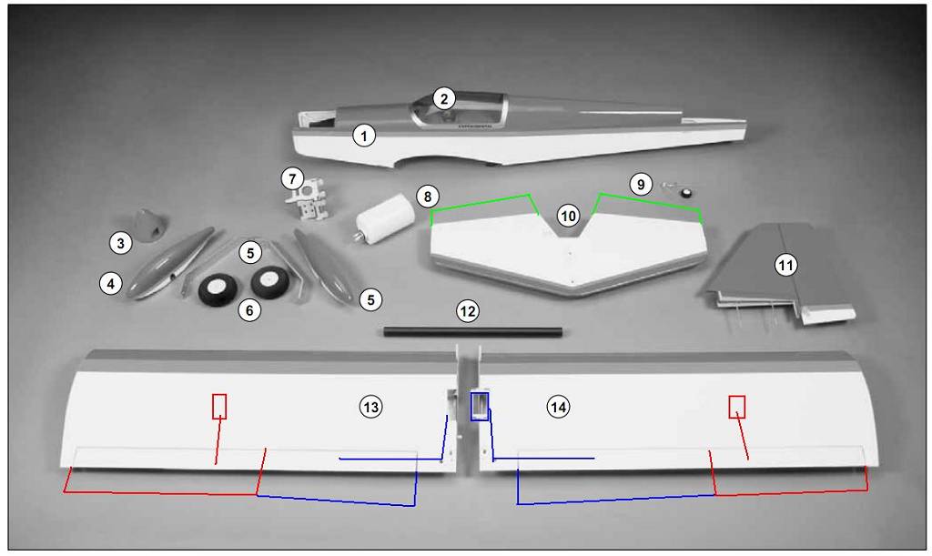

Has anyone modified the Great Planes Escapade 40 for flaps? I was thinking about getting one and modifying the kit for "in wing" servos for the ailerons and it looks like it could easily be modified for flaps as well. How much of the aileron should be used for the flaps? (20% - 30% of the total length on each side)

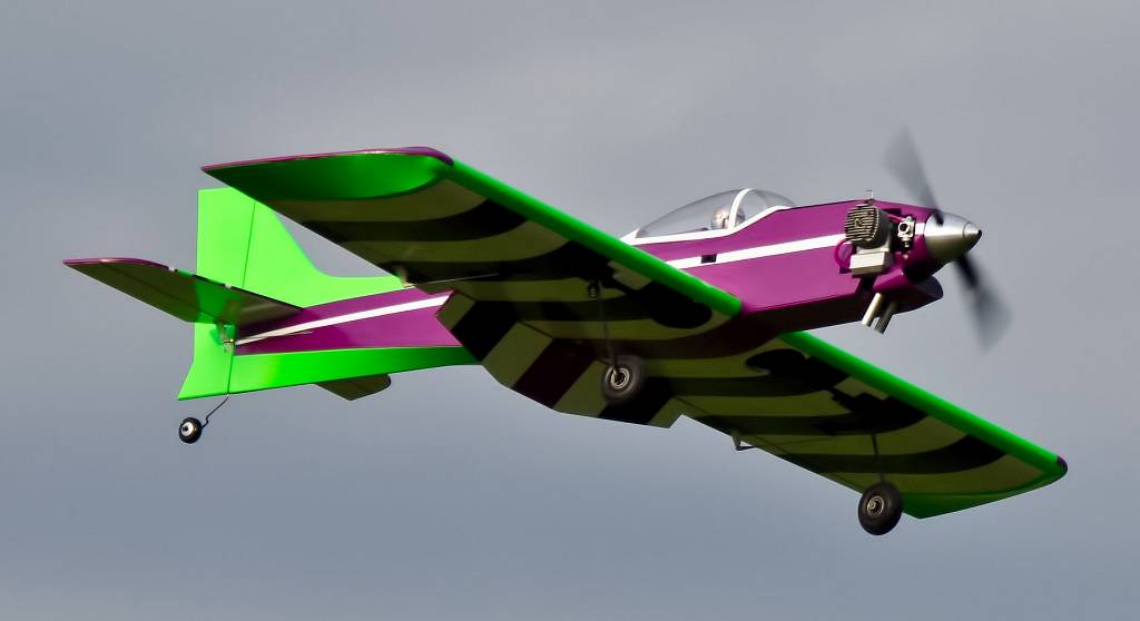

I built a Contender this spring and it sure doesn't need the center flap either, but it's a blast to have. Just last week I was making pass after pass straight down the runway, gear retracted, two to three feet off the ground at a snails pace. It's worth the effort if you want to have something to play with. Plus it will teach you about flaps for future models that need them.

Consider that it is not as easy as splitting the ailerons.
You could do so at about half of the aileron's length; however, you will need to compensate for the area that will be subtracted from the ailerons, or the roll capability will suffer.
Hence, you will need to replace each aileron for one with double chord.
The flaps will have chords similar to the ailerons and could be controlled by the central servo via the original torque rods.
By doing all that, the area and lift of the wing would be increased in around 12%.
Because of that and because flap deflection usually results in nose down or up pitch, the elevator surface may need to be increased as well.

Thank you also for the Wikipedia link and for taking time to mark up the attachment. Any thoughts on flaperons instead of flaps?

I have the Escapade 40 - been flying it for 3 seasons. It would be easy to modify it for flaps. Make the outside 2/3rds of the current aileron the new aileron and use the in wing servo positions to hold the servos. Use the inside 1/3rd for the flap and use the existing torque rod and center servo mount for the flap servo. Should be fun.

The color scheme on that Contender is really wild; I like it. I am sure you have no trouble seeing it.
