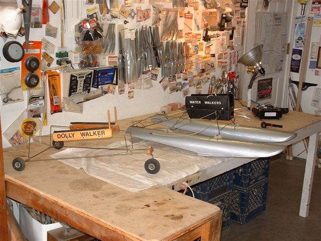

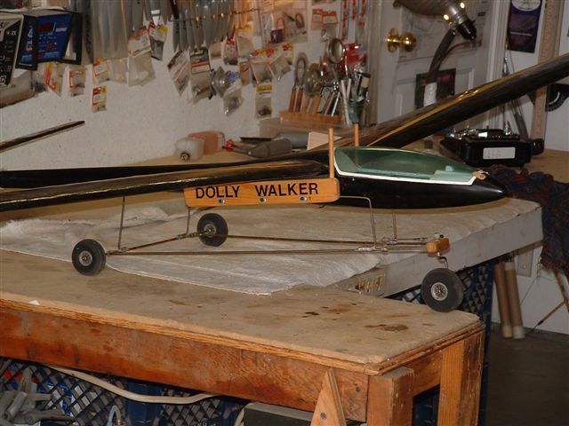

Here are a couple of shots of some dollys we use that I make up both land tow and water tow. I also added a link here of a tow using my current tug a Great Planes Stearman towing the Oxy Moron a bashed Seniorita for a aerotow trainer that also serves as a twin engine trainer its a quick change artist.
http://www.youtube.com/watch?v=wwXN8Z2inyo

I'll probably filch your dolly design ... it's better than the one which I had in mind for my Ivory Gull.

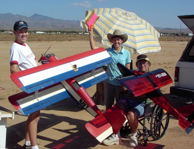

Please be my guest Boq, the vid of the double tow is awesome never tried a double tow not even when I was still active in full scale, of course the big problem would be a turn. Seems likely that it may end up like WW11 when the Germans attempted to tow the Me 321 with three Me 110's
This is my current tug the Stearman with an OS 120FS, previously have used a Midwest trainer floatplane with a K&B .45 for the water tows, two different Lazy Ace biplanes one with an OS 1.08 two stroke and one with a G-23 gas engine, and a Senior Telemaster with a Magnum .91FS.
