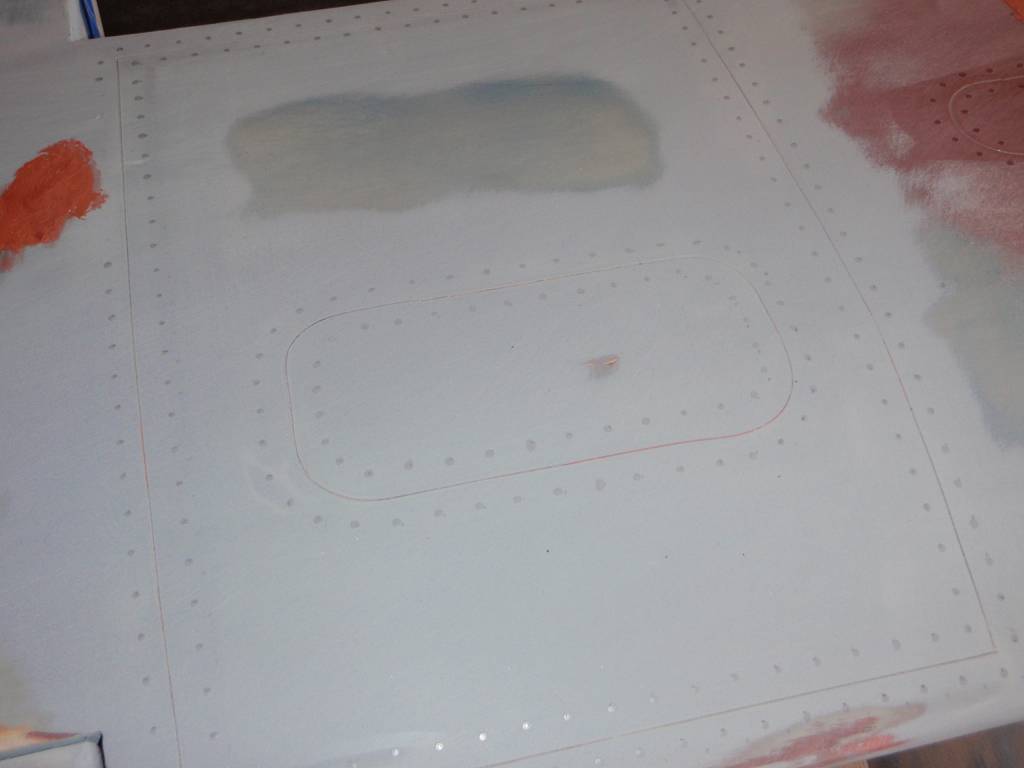

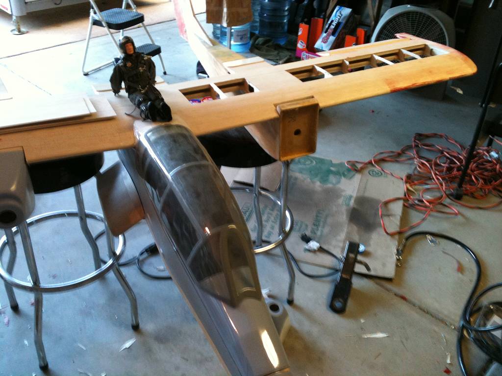

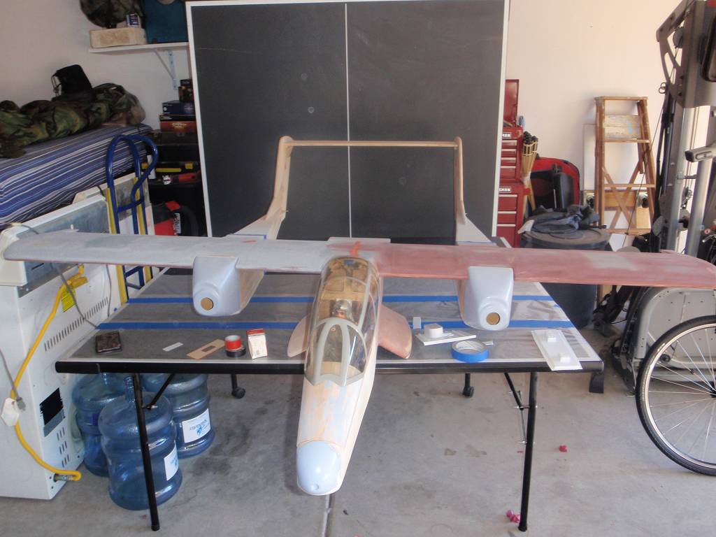

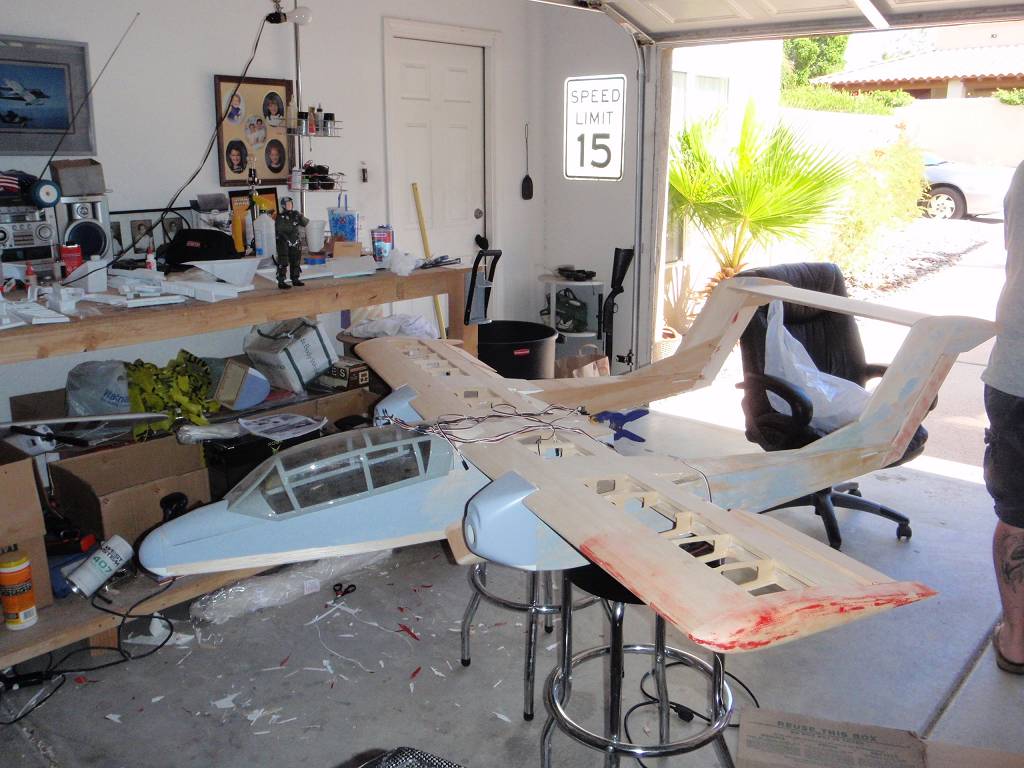

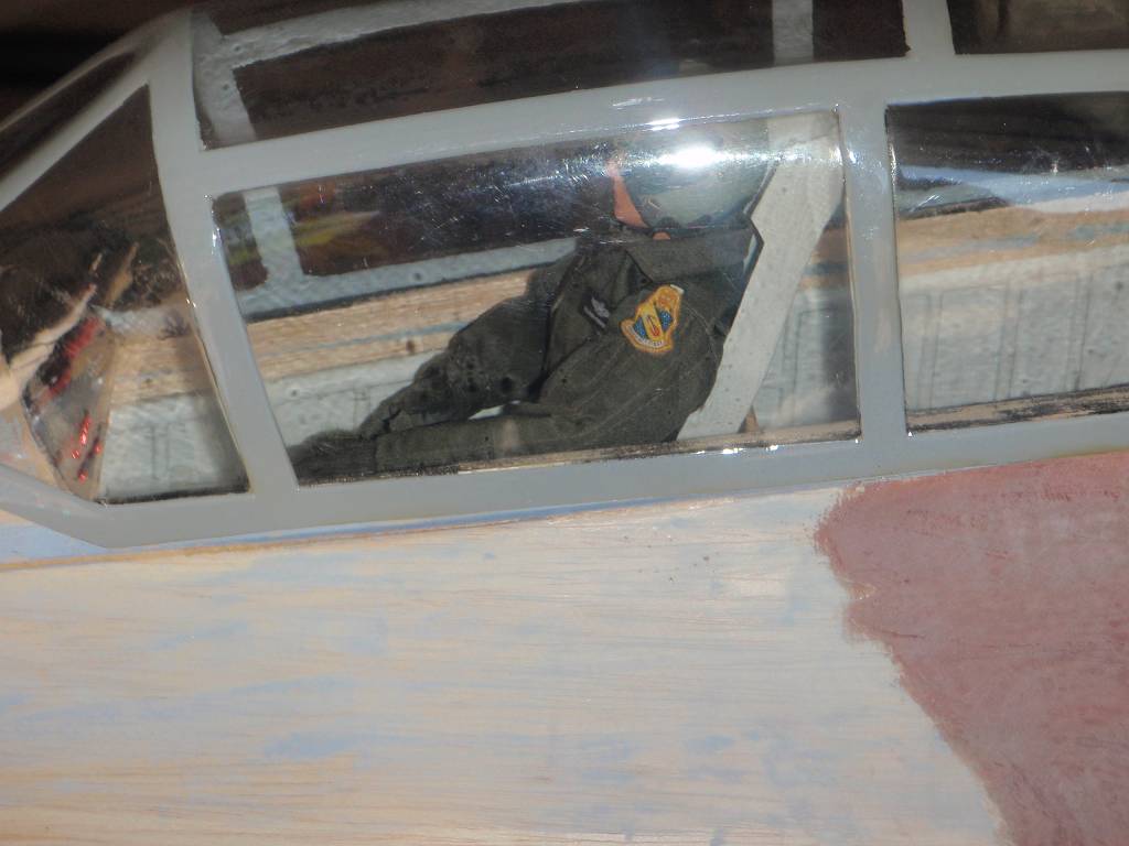

Hello,
I am building a 81" OV-10 bronco Hobby Hanger ARF. I have glassed the whole plane putting in robart retracts, scale cockpit with pilots, and I hope nice aluminum wheels to be painted white to match the Shinden struts I want. I have put body lines and rivets on the wing still need to do the fuse and tail booms. Anyway the question I have is: will DLE 20's be enough power for my plane I think it might be a tad heavy? Thanks for any help you can give me.
