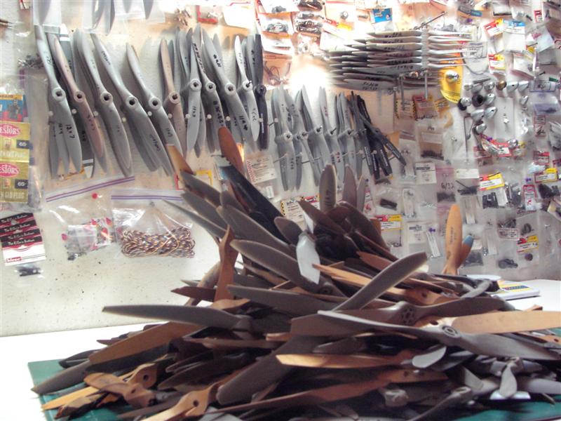

In full support or gaRCfield here it is impossible to select any given prop based simply on max static RPM. What you need is a PropWall for every displacement class and engine type you fly.
My suggestion is go ahead and open those props and have them ready when flying commences along with a reasonable selection.
If You are new to that displacement class having primarily always done other sizes or types its time to start on that 90-120 class Prop wall
John

I'm loving that prop wall!
Guess I'm just jealous!

I'm with John, you can't have too many props. I don't put too many on the wall, because I don't have that much wall space. But I have maybe 5 or 6 hundred props (maybe more) in boxes, drawers, and also a wall. Most are Rev-Up or APC.
