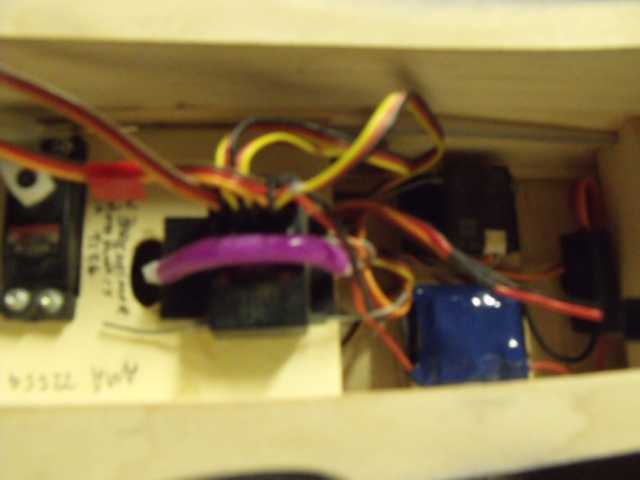

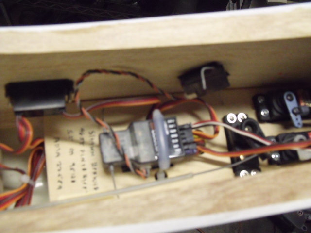

Why do you have 2 batteries, in a Skyraider? especially with different voltages...the extra battery is extra weight
Not being a Spektrum guy I'm not sure why the receiver was wrapped in foam....most 2.4 systems set the receiver open on a bed of foam to keep the heat down

I wraped it in foam because that is what someone at my club said to do. The satalite reiciever is not wrapped in foam, it is on the side of the plane with velcro on its back.I have to batterys in it because I wanted to make shore it was not the battery causing the problem!!

The new 2.4 receivers are all surface mount and have no crystals so a peice of velcro and a strap is all that is required. The strap should not be too tight. I like to use a small zip tie with running through some fuel tube. It is important that the antennas not be next to the RX for optimum range. Here a couple of fair examples.

When you have 2 power sources in an RC airplane going from switchs to a Y or from switchs to the receiver that is parallel circuit....for the sake of this discussion we'll say the batteries are at 6 V and 4.8V right now...out put would be 5.4V. A 6V battery is 5 cell. Consider a battery discharged at 1.1V a cell and you have 5.5V .
The other thing to consider is the internal resistance of the batteries. The 4.8V battery is a load on the 6V battery...a loads by product is heat...Batteries don't like heat.
It is always best to run the same voltage and same mAh batteries in a parallel circuit where voltage stays the same but availabe current is doubled or gives longer running times between charges. Your Skyraider is probably using standard sevos, your 6V battery at say 1000mAh would be enough for all day. Heck the 4.8 battery at 700mAh would be good for 3 to 5 flights
So 2 6V 1000mAh batteries out put would be 6V, but the available current would be 2000mAh in a parallel circuit....2000mAh means that the batteries can deliver 1mA for 2000 hours or 2000 mA for 1 hour.....
Your extra battery is not needed
Good luck
