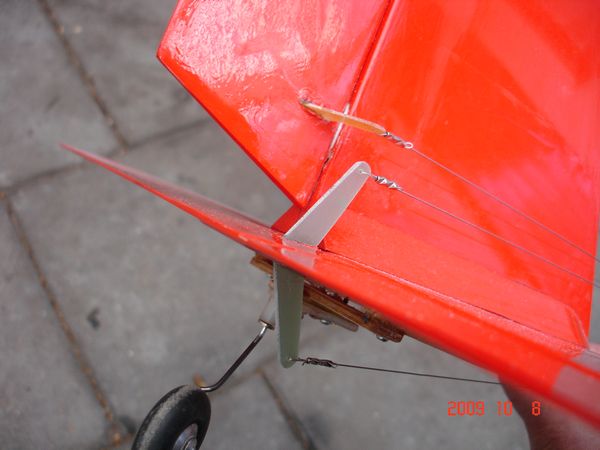

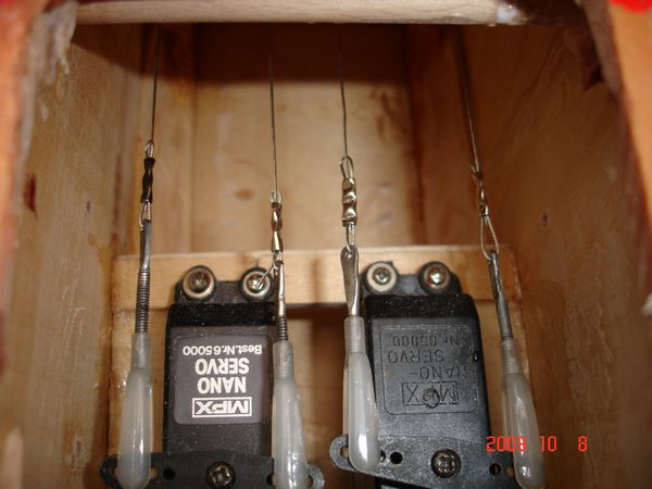

Hi!
Why use a 40 inch long steel wire?? Its too flexible och heavy!
Either use a balsa rod with steel end peices or carbon or alumium tubing (arrowshaft) or best; a pull-pull wire system!
