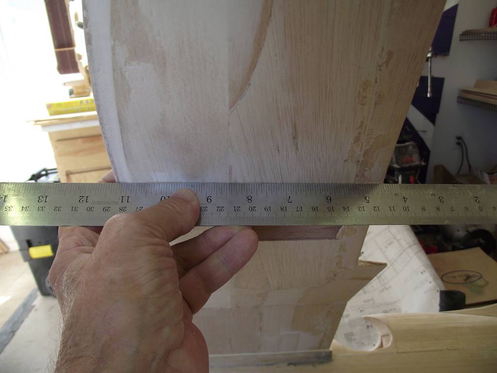

CHAD, would this qualify as a flat enough, sharp enough leading edge??
Just screwing with ya. It isn't often on a clark-Y that I would have a LE that sharp and flat. Mater of fact, without the rounded LE is this a true Clark-Y? Never mind, that is another can of worms of a question.
The Swoose is an easy build if you have the original build article from 89 and I do. Nick shows the wing jig he uses on a gull wing and it is great. Wish I had thought of it when I was building a Corsair!!!!!!!! One jig builds both wings and it is a normal one piece wing halves, makes any gull wing easy and the Swoose even more so.
That's about as close as you can get to flat bottomed Gray Beard! The Swoose has to be one of the most classic of r/c designs. A real challenge for the builder but the finished product will be most satisfying I'm sure. Best of luck with it.
