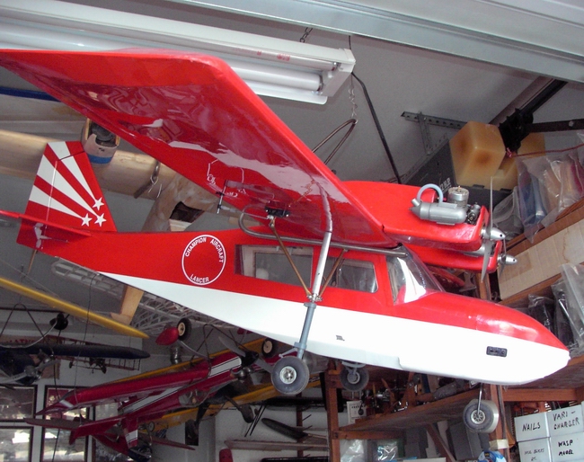

Here are photos of two of my twin engine ships using .25's and HS-85's on the airlerons and both have been performing well for a number of years now. One of them actually is a Seniorita flown with the .25's or without and aerotowed:

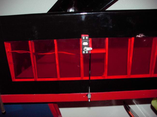

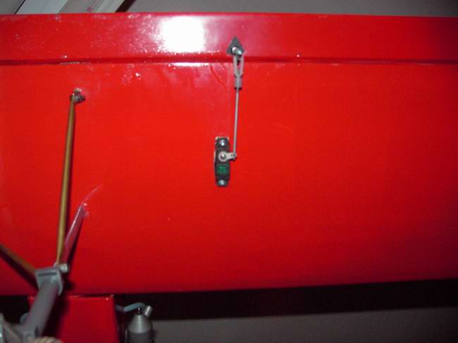

Anyway 1 Pitts here are a couple of photos of the only a few of my ships that I promised a few days ago, using the HS-85 as well as the HS 225 mini (Which is by far my favorite).
Also for most of my custom stuff I favor simple surface mounts as in the pictures when making a conversion far simpler to do and far more practical especially at the field than the buried ailron servo plates that everyone thinks is such a must, Nope not me.

Thanks for the pictures. The servos are easily installed. Very nice job. They are quite small at that as well. I have used nothing but standards an retract servos for the longest time I really would have been afraid to try them. Running those small servos on a twin is impressive. I would bet I could use theses smaller servos on my Pitts. One thing is for sure I will take some time to search the servo charts for my next plane. The plane I am helping with still plans on going ahead with them installed as your pics. This is a real learning experience.
