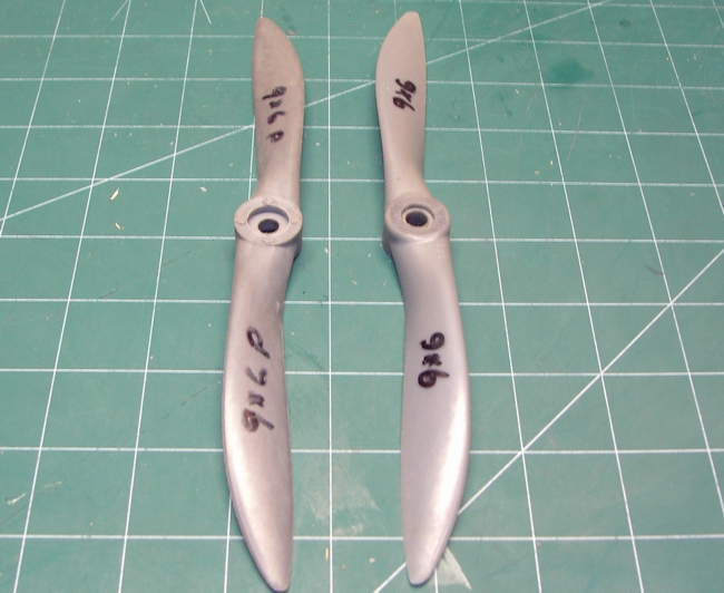

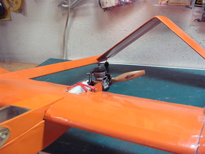

Possibly a couple of photos will help visulize things. Look carefully at the photo of the orange airplane it is my creation with pusher engine installation and it pretty obvious how the prop is mounted, label facing the front of the aircraft and facing the engine. The other photo is an APC of the same size except one is a 'P' prop.
Now there is one execption to all this and that is most often talked about with twin engine airplanes. There are some advantages to reversing the run direction of one engine and when this is done on a conventional twin the engine that is reversed must use a (P) prop and it not mounted in the normal manner as above but instead with the "label" facing to the front same as the other engine.
