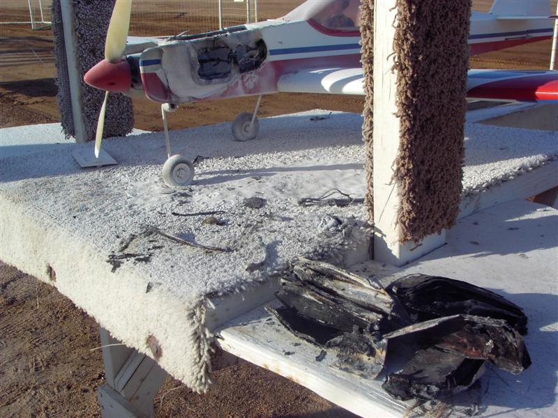

Not a electric guy and the only batteries I use is for the TX, RX and field equipment. Our field has thirty stalls in two pavilions. Each stall has 110 outlets for charging. Yesterday a person was charging a LIPO and the thing burst into flames. Never have I seen such a thing. We have fire extinguishers located in places along the field. The fire was quickly put out. My question is what in the world happened. The person had been charging all day and nothing seemed wrong. After all the excitement the charger was checked out and appeared to be OK. Could the battery gone bad or could the charger malfunctioned?

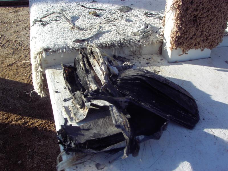

Old 06-10-2013 | 07:48 AM
JohnBuckner's Avatar
Posts: 10,441
Received 11 Likes on 11 Posts
From: Kingman, AZ
Default RE: Battery Burning
ORIGINAL: Villa
Should I stop using the battery? The batteries have never been damaged.
If they are puffed at all then yes they are damaged and yes that battery is history totally unsafe to use and easily can end up looking like this one. This not just some picture off the net, I took this picture, it happens.
John

ORIGINAL: raptureboy
Not totaly true. They all will puff some after a hard discharge but are not necessarily bad. I have some that I have been using for years that do this. Follow the rules, use precaution and you will be ok.
And just what do you think that hard discharge is raptureboy? Its damage that's what it is so now tell me are you prepared to accept the libiltity if Villa has an incident. Exactly how little puffing can one be safe with and are you prepared to tell them what it is and what is not safe, I think not. Your cup may be half full but be assured the lawyer that can come after you, their cup is half full.
You yourself said follow the rules and every rule out there will tell you puffed batteries are damaged batteries and are unsafe.
John
