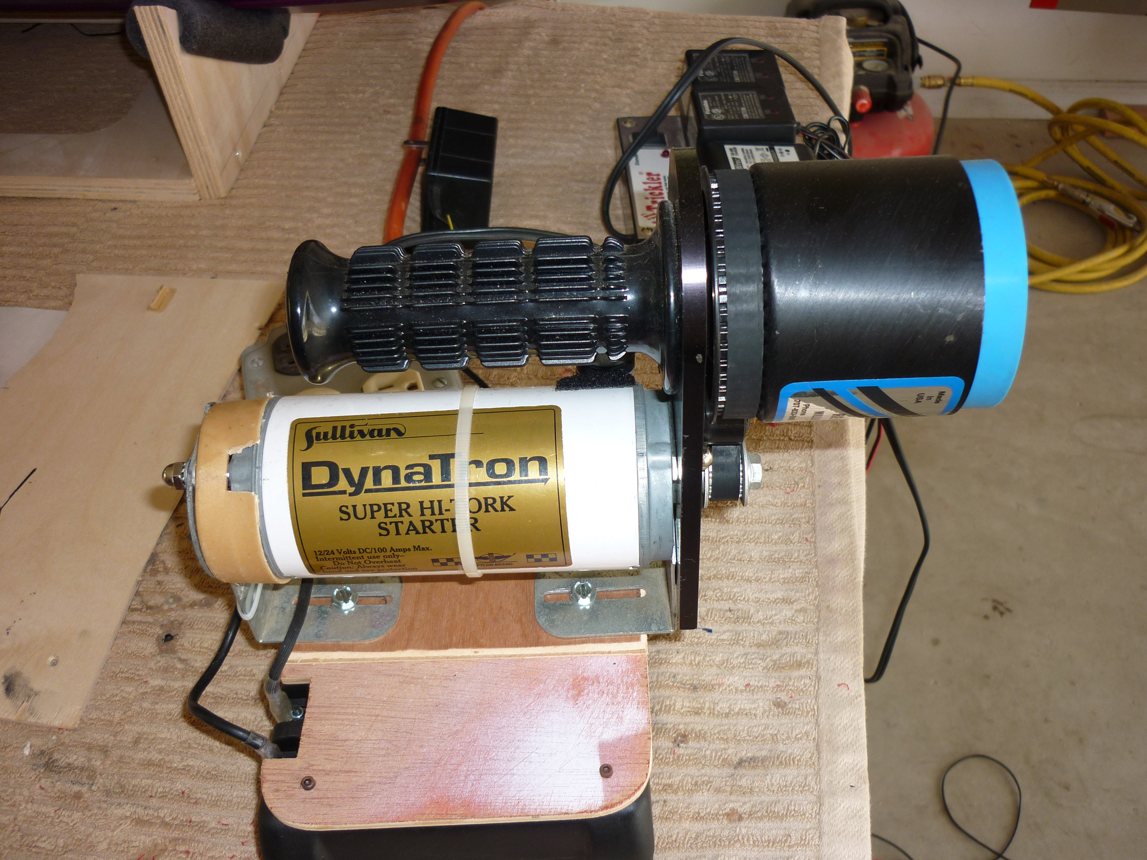

I have a Sullivan Dynatron starter with a Miller reduction belt. Ordered 2 of the 12V starter packs from Hobbico. There real junk.... won't even hold a charge for one start. (using to start a DLE55 and DLE30). Have since bought 2 Sullivan packs (which they don't make any more, but the batteries are toast. Can someone tell me where I can the batteries for these packs and another charger unit. I'll need 12 batteries for each pack. Thanks for any help

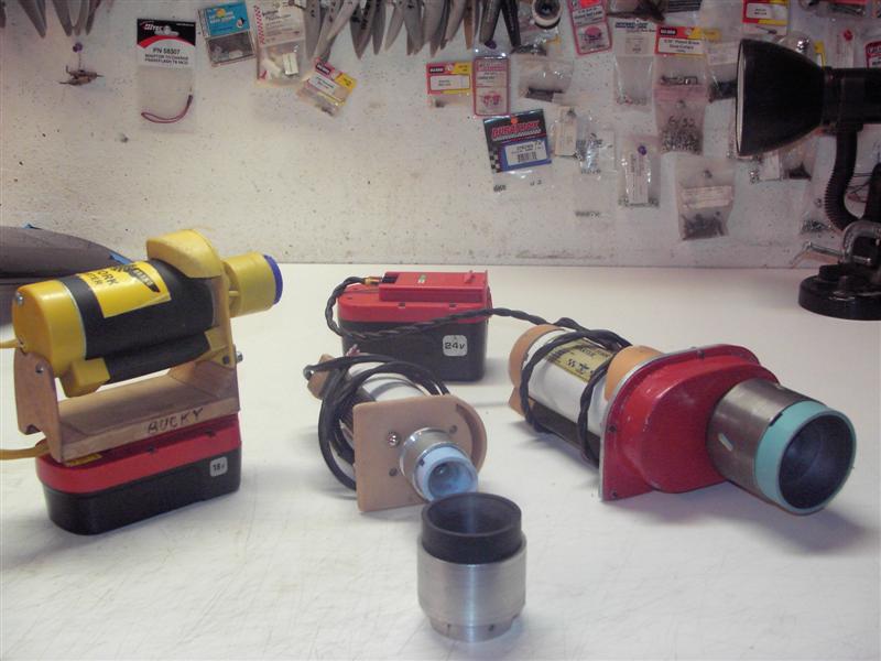

Old 03-14-2014 | 01:51 PM
JohnBuckner's Avatar
Posts: 10,441
Received 11 Likes on 11 Posts
From: Kingman, AZ
No, no go straight to your local hardware/tool store and order a Black @ Decker 24 volt nicd drill battery pack, This pack is already made and provides the optimum voltage for the Dynatron to provide awsome performance. The Nicd cells have the ability to give up a lot of current without damage Also they are not seriously affected by deep discharge which is why I shy away lipo's for starters. This becomes very important when your starter is the most popular on the flight line.
I love my Dynatrons and have two one is direct drive and I can alternate between a one inch cup as well as a quickly removable two inch cup. The other has my home maid gear drive and this one has a three inch cup. It depends on what I am flying as to which I will use and for the smaller stuff I will use the 18 volt black and decker drill battery but the geared starter with the 24 volt battery has no problem with my OO 55GT and my G-62. The direct drive Dynatron with the 24 volt Black and Decker has not problem at all with my OS 33.
John

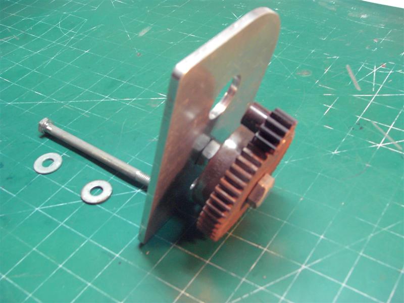

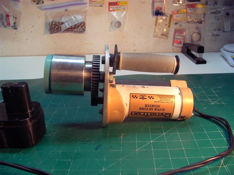

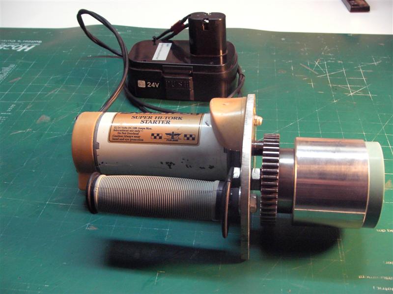

Old 03-23-2014 | 08:14 PM
Posts: 10,441
From: Kingman, AZ
Hi Mike sorry I was late in getting back to you. Yes my starter is a home made system that was first devised by a gentleman who was intending to sell them actually many years ago now. He finally retired from modeling altogether and his original prototype was snapped up by another local flyer and when the other local said he had parts for more of them I immediately connected with him and was able to buy all the parts to put one together except the cover which I later cobbled one up.
I am sorry I know that is not what you want to hear since I cannot answer your questions as to a gear source etc or even what the actual ratio is.
John

Old 03-24-2014 | 04:03 AM
Joined: Jun 2005
Posts: 264
Received 5 Likes on 2 Posts
From: BELLINGHAM, WA
John: Thank you for breaking it down so I could see the inter workings. Really not that "technical" to what a person is trying to do. I am going to keep your response in one of my "I shall build it" favorites and work off of that. By the way, I really like your cutting mat, it shows that your "doin' your thing" aka, a lot of wear.
Thanks again.
