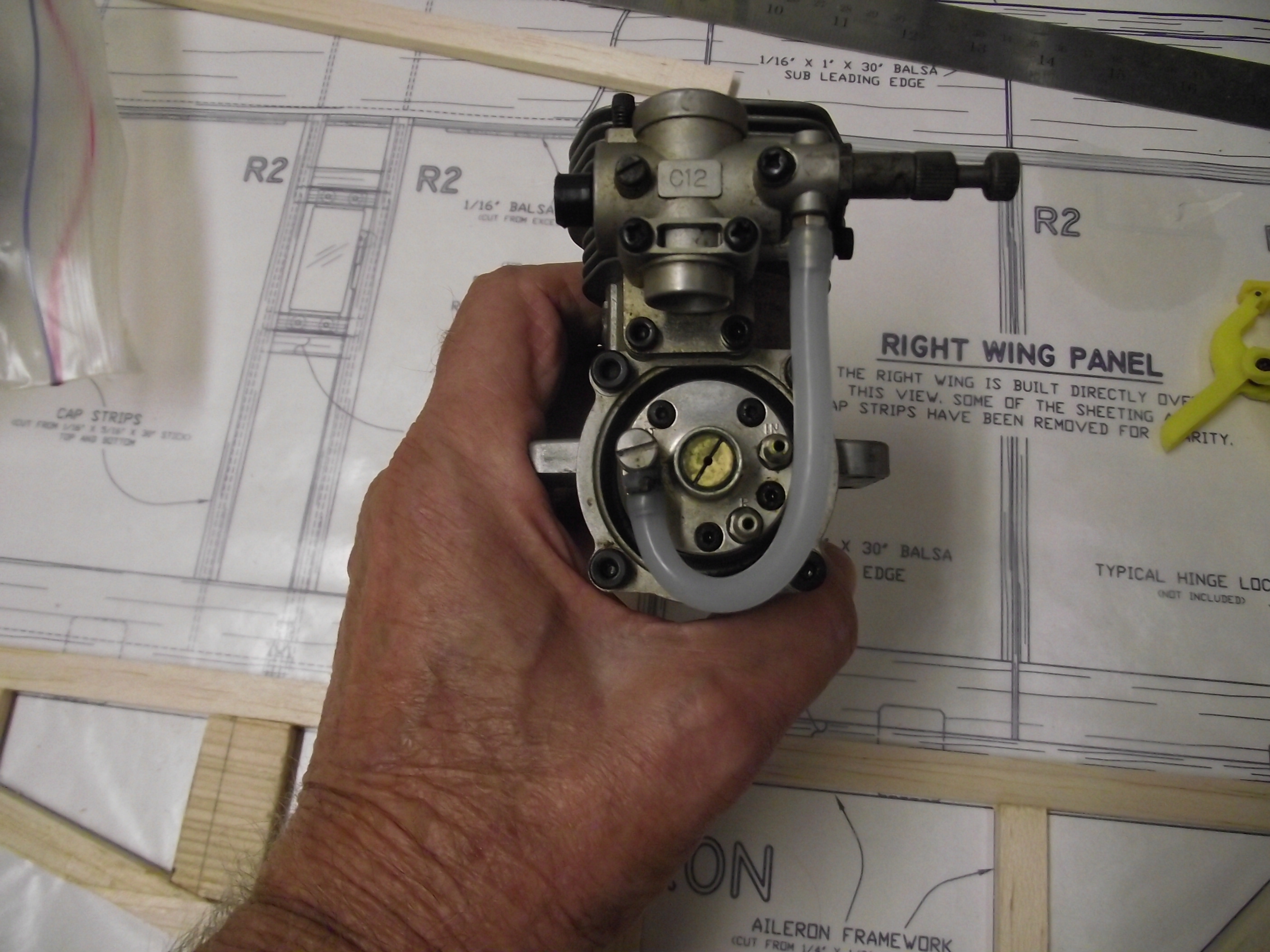

I have an FS-120 surpass pumped. The pump is leaking and I can't find anyone with parts to repair it. Hobby services suggested I try the forums, so here it goes. Anybody got parts that could help?

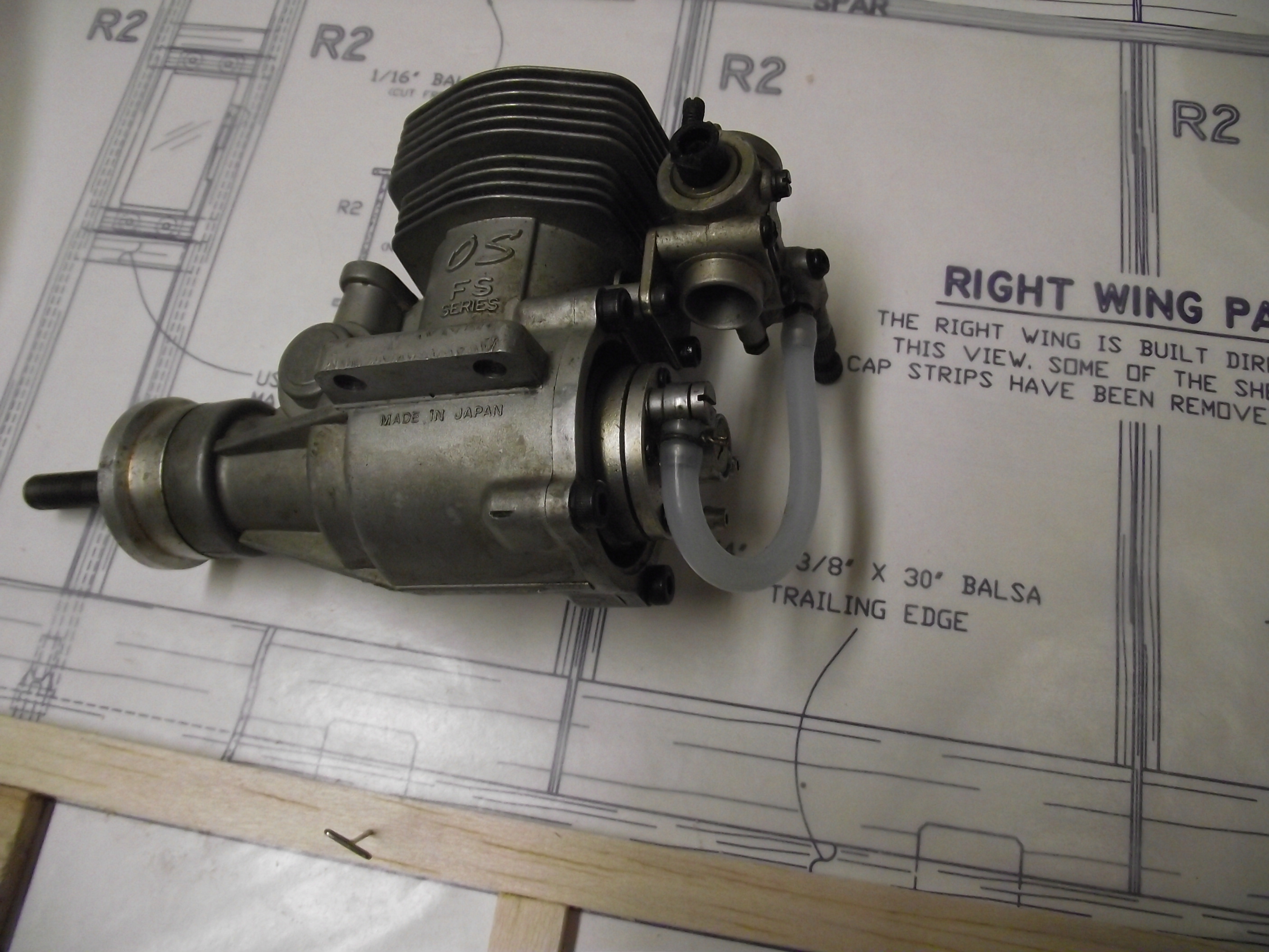

I believe it's a metal pump. The engine just says FS series on the side. I think the diaphram in the pump is leaking because I get an excessive amount of fuel through the bleed hole on the pump back plate. I'll try to attach a picture. Thanks.

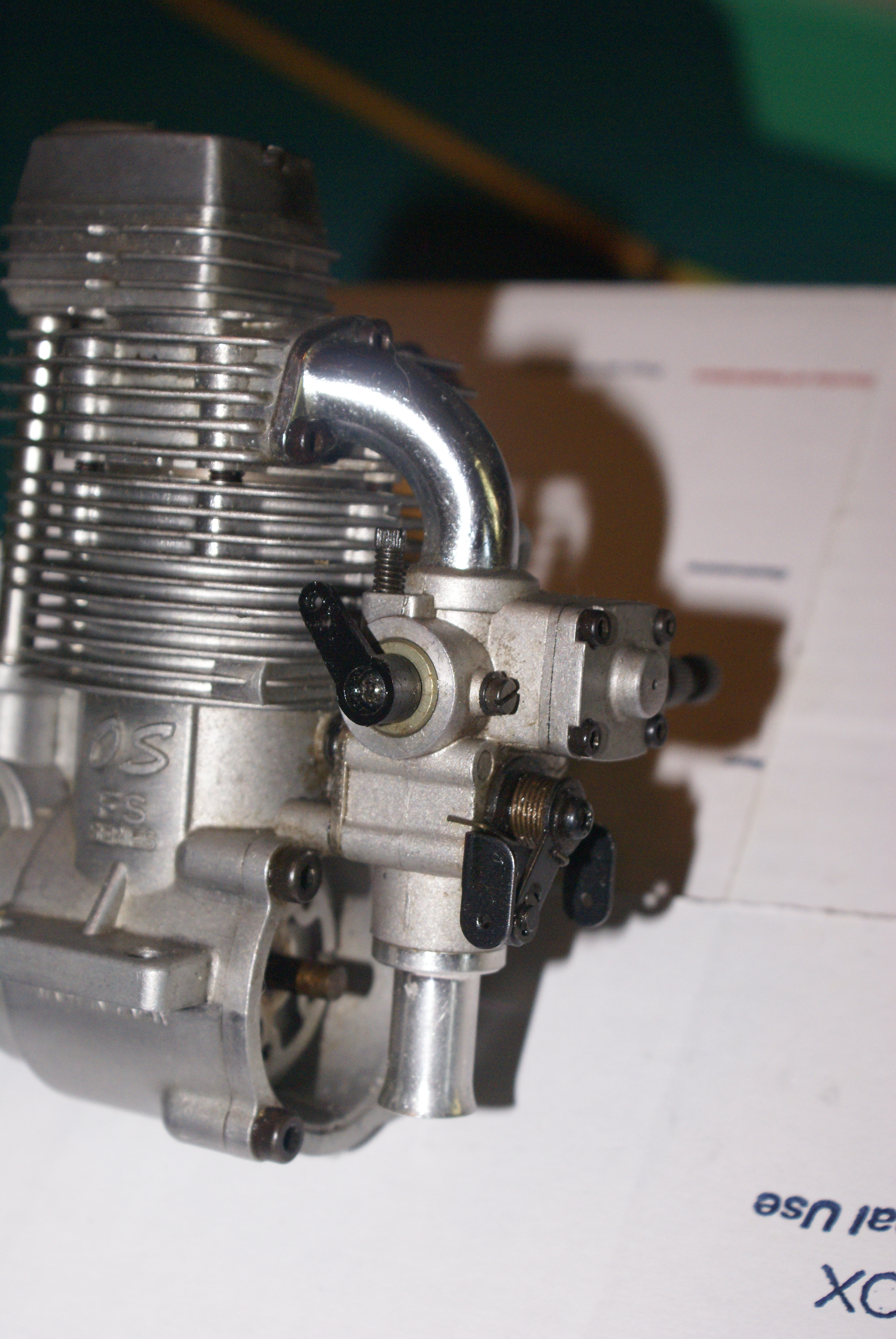

Sorry, I can't be of any help at all. I'm not real familiar with the first two pump types that OS started out with and have never had the type you have. I think? Think you have the second type tried by OS? For questions go into the glow engine forum and then into factory support and ask Bill Baxter. Bax may be of some help? This is the type I have on hand and thought maybe I could help you out with some parts but it's not going to work. OS hasn't used either type of pumps in years but someone else may have an old parts engine on hand. Only thing I use this one for are screws. It was running but I could never get it adjusted to make any power so I trashed it when I got a newer model with the new type of pump. When that pump went out I moved on to another brand of engine.
Your engine is an O.S. FS-120 Surpass II that is missing the pump. You have the C-13 carburetor installed, but somebody's removed the pump from the rear cover. What you are likely calling the "pump" is the regulator. That carburetor cannot operate properly without the pump. The carburetor requires a differential of at least 10:1 between pump pressure and engine demand in order for the regulator to work properly.
The regulator has not been available for years. O.S. stopped making the engine in 1996, and parts were discontinued around 2001 or so.
You will have to see if you can find a pump, which is normally part of the rear cover of the engine. You'll also likely need to locate a new carburetor, since the regulator was not sold as a separate part.
