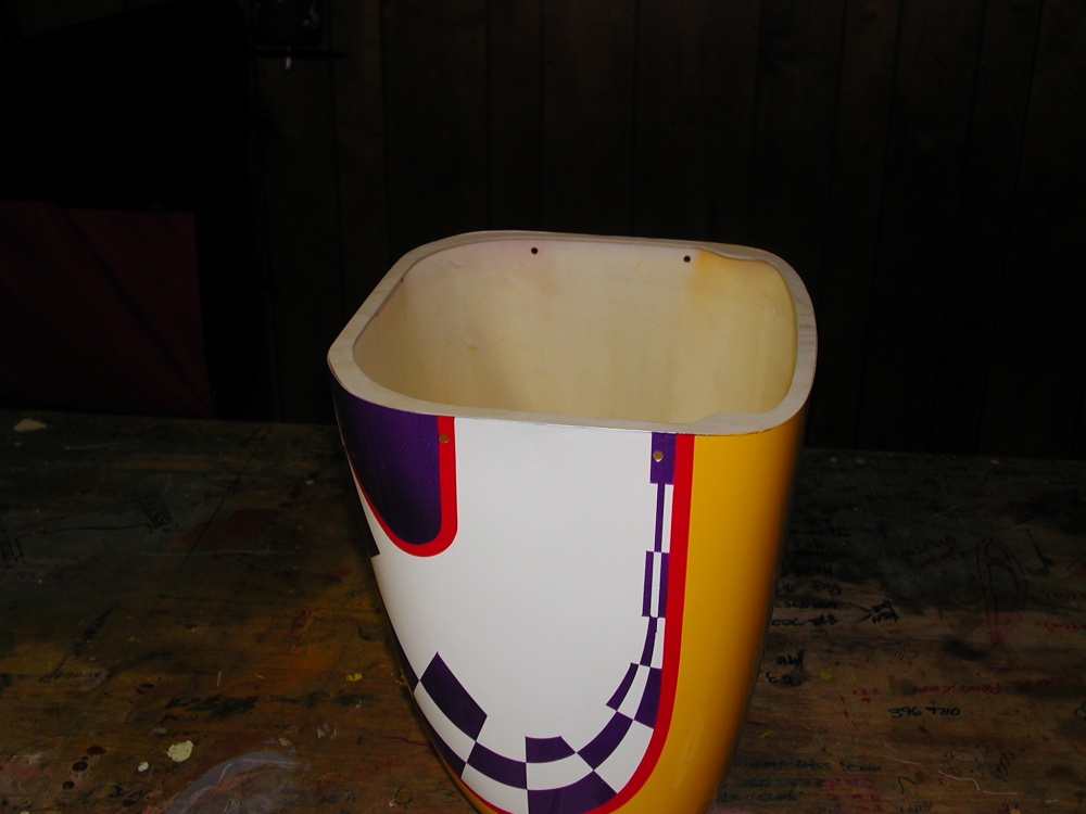

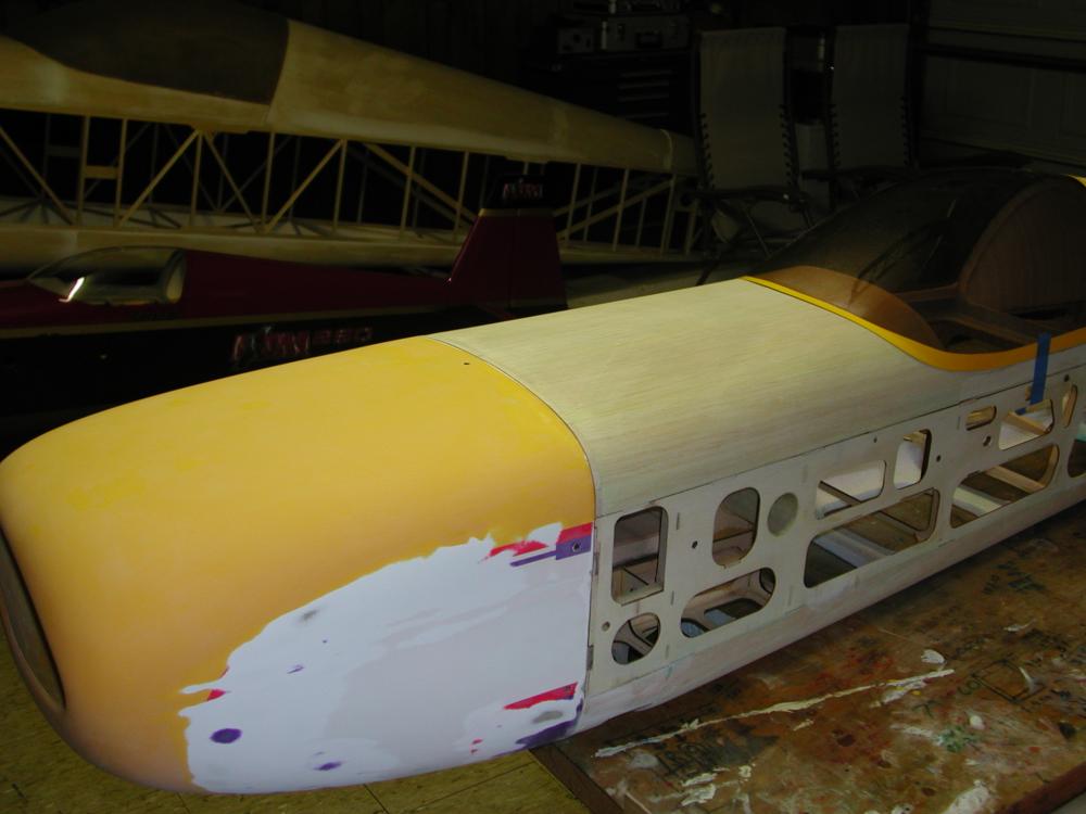

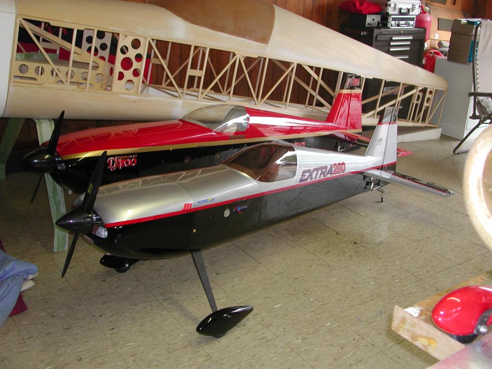

This is what I did on my Hanger-9 35% Extra 260 cowling.
Before sanding, After sanding,and after paint. As already stated, there is no good reason to take off all the paint, it serves as a good base under your new finish, I did dust a light coat of primer and re-sanded prior to my topcoat application.
Bob
