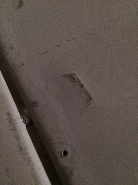

I'm looking for advice on repairing a total mess-up on my part where I over sanded the primed koverall on my airplane's elevator. I just got too aggressive trying to remove a small paint run and now I'm stuck trying to decide how to best repair. I can feel the weave fibers but can't tell if it went all of the way through. The primer used is Gray Klass Kote #50.
Thanks in advance.

Hi
Although not with Koverall but when I have sanded thru the KK primer to balsa over fiberglass cloth I carefully applied a very small amount of thin CA using the small tubes to stiffen up the surface and sprayed on a light coat of the KK Primer over it. Then lightly sanded with 320 paper before final paint.
You might try applying a very small about of the KK Primer with a small brush to "stiffen up" the fabric and then ever so lightly sand it to blend it in.
As to a primer over a Koverall/ nitrate Dope surface as well as natural Solartex/Nitrate have used F&M St*ts Polyspray with excellent success over a fabric surface. Then applied the KK paint directly to the PolySpray. The Polyspray helps fill any small bumps on leading/trailing edges with almost no weight and sands ever so easily..
